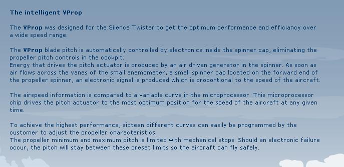

alex_01
Joined: 14 Jan 2007
Posts: 33
PostPosted: Thu Jan 31, 2008 3:07 am    Post subject: Re: Spinner with Cooling Fins Reply with quote
please have a look here
http://www.silence-aircraft.de/index.html
under propeller

planecrazydld(at)yahoo.co
PostPosted: Thu Jan 31, 2008 3:47 am    Post subject: Spinner with Cooling Fins Reply with quote
http://www.v-prop.com/
Also the Zlin trainer has had a vane driven automatic prop for years. model 526?
