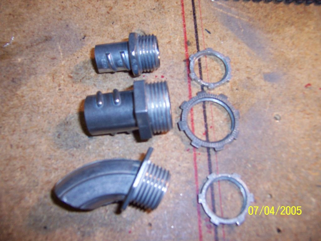

Bill Schlatterer
Posts: 195
PostPosted: Thu Jan 31, 2008 5:42 pm    Post subject: Firewall penetration Reply with quote
Just FWIW, I posted a similar firewall penetration a couple years ago using
the cheap pot metal electrical connectors shown in the attachment. I was
cautioned to AVOID any of the fittings that were made of cast steel
compounds (gray looking pot metal material) because they would actually burn
very well under modest flame. Was told to ONLY use the steel tube/forged
fittings which were much more expensive but would not burn.
I did not put a torch on them to find out but thought I might mention it.
Pictures of the rejected fittings attached.
Just what I was told on this list back then.
Bill S
7a
 Filesize:  97.64 KB
 Viewed:  913 Time(s)
Joemotis(at)aol.com
PostPosted: Thu Jan 31, 2008 6:07 pm    Post subject: Firewall penetration Reply with quote
Those connectors are made from ZAMAC and have a melting point of around 750 degrees. You can melt them in a saucepan on a gas cooktop.
