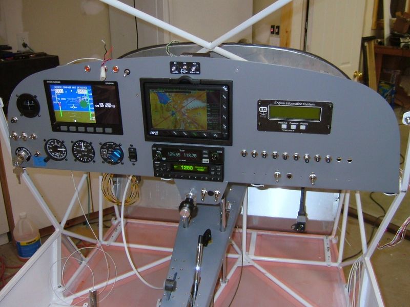

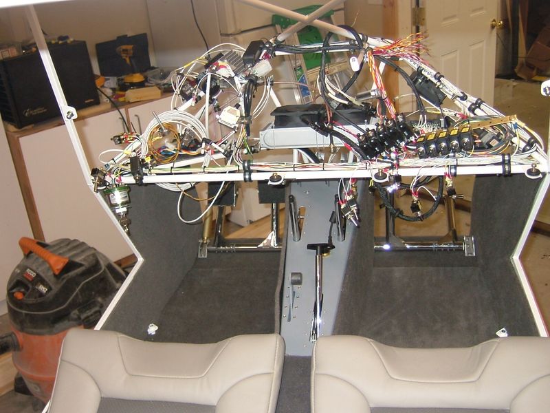

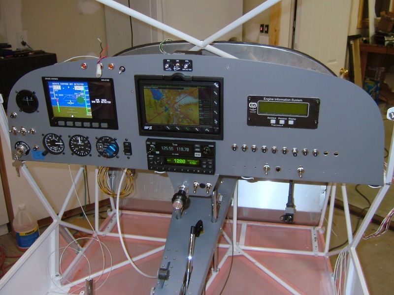

PostPosted: Sun Feb 03, 2008 10:14 pm    Post subject: Re: Completed Kitfoxes Reply with quote

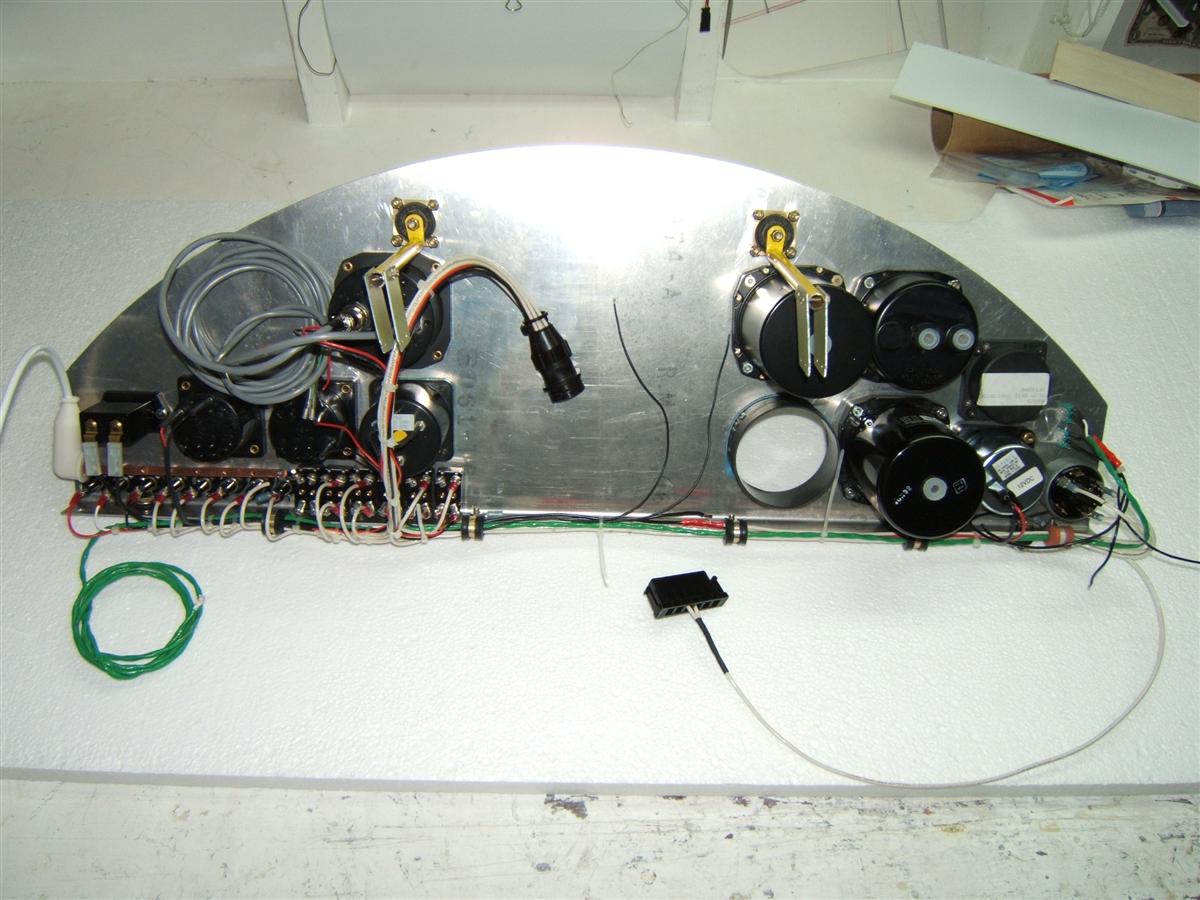

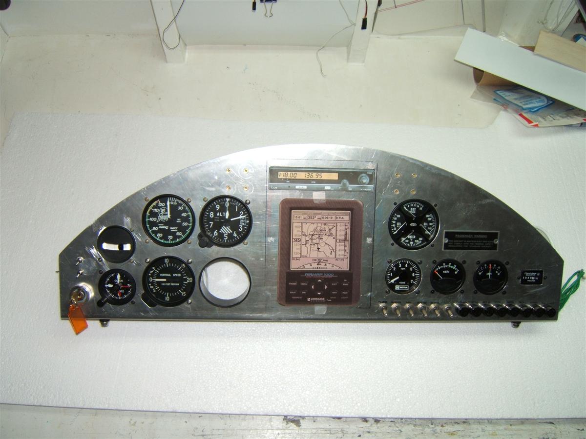

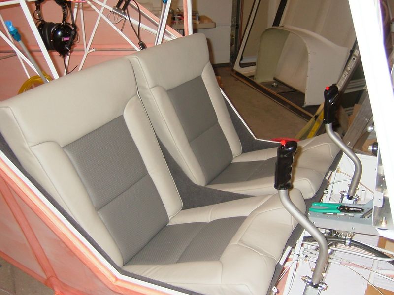

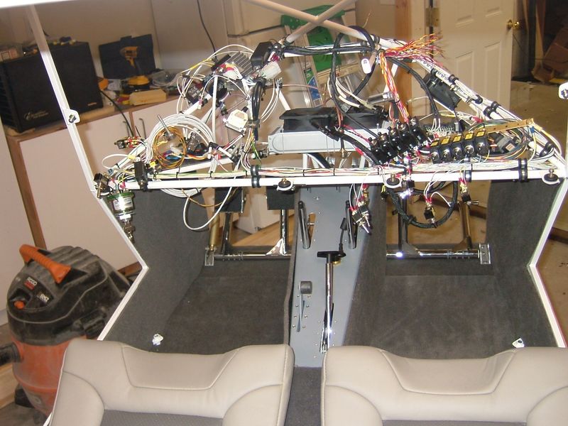

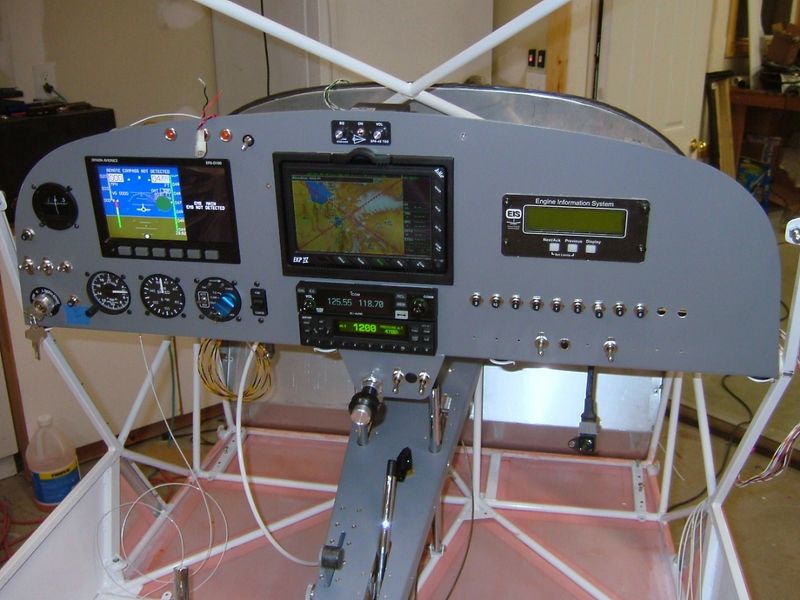

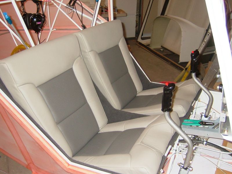

I can't believe this post hasn't had any takers?? I guess I will be the first, hopefully not the last! Unfortunately, mine is not yet complete but the panel is getting very close so I will post some pictures of it and my interior which is pretty close also. I should mention that the panel is out now getting repainted and engraved. Come on guys...inspire us!

PostPosted: Sun Feb 03, 2008 10:42 pm    Post subject: Completed Kitfoxes Reply with quote
Darin,
I looked at your pics. Man I think you are going to have a show winner
there. That is one beautiful piece of work. Keep going. We spoke some
time ago on the phone about engine choices. Wish I was close to lend a
hand.

WOW very nice,Thanks for the great pictures..LOOKS GREAT,,,STEVE SHINABERY N554KF KF2

PostPosted: Mon Feb 04, 2008 7:28 am    Post subject: Re: Completed Kitfoxes Reply with quote
Thanks for the nice comments guys, I like it too.
Rick,
I wouldn't mind a hand or two, especially during the covering and painting stage.
Let's see some more pics guys.

PostPosted: Mon Feb 04, 2008 1:54 pm    Post subject: Completed Kitfoxes Reply with quote
Looks good Darin! Your panel looks somewhat the way mine will on the left side.
http://www.azshowersolutions.com/Panel5.html
Keep up the good work...it's getting closer! :>)

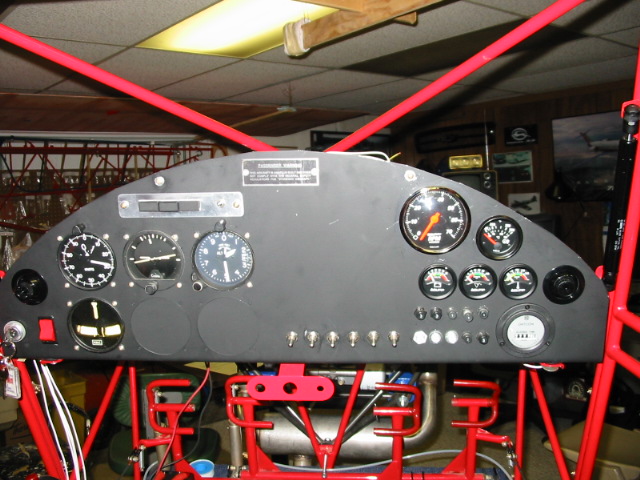

I'm on the home stretch with the panel layout in my Classic IV. Nothing fancy but pretty to look at. A second hand Lowrance GPS will sit in the center with a new, low end ICOM radio on top. The remaining round hole will likely hold an intercom unit. Most of the wiring runs through a 16 pin connector so panel R and R won't be a chore.
Good looking panel, Gary; however, I suggest some changes in instrument positions. You'll most likely find that you will want certain flight and engine instruments within your immediate view, especially during takeoff and landing. I suggest you move your clock to where the tach is now (you don't really need to refer to the clock very often); place the tach where the ball is now (so you can easily see it without moving your head away from your immediate view outside the cockpit); and place the ball where the clock is now. I have mine set up similarly to what I am suggesting, and after almost 1300 hours find it very suitable.
Keep up the good work!

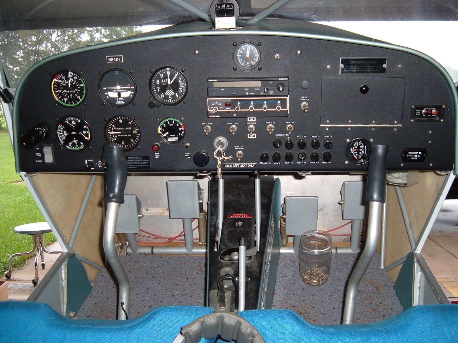

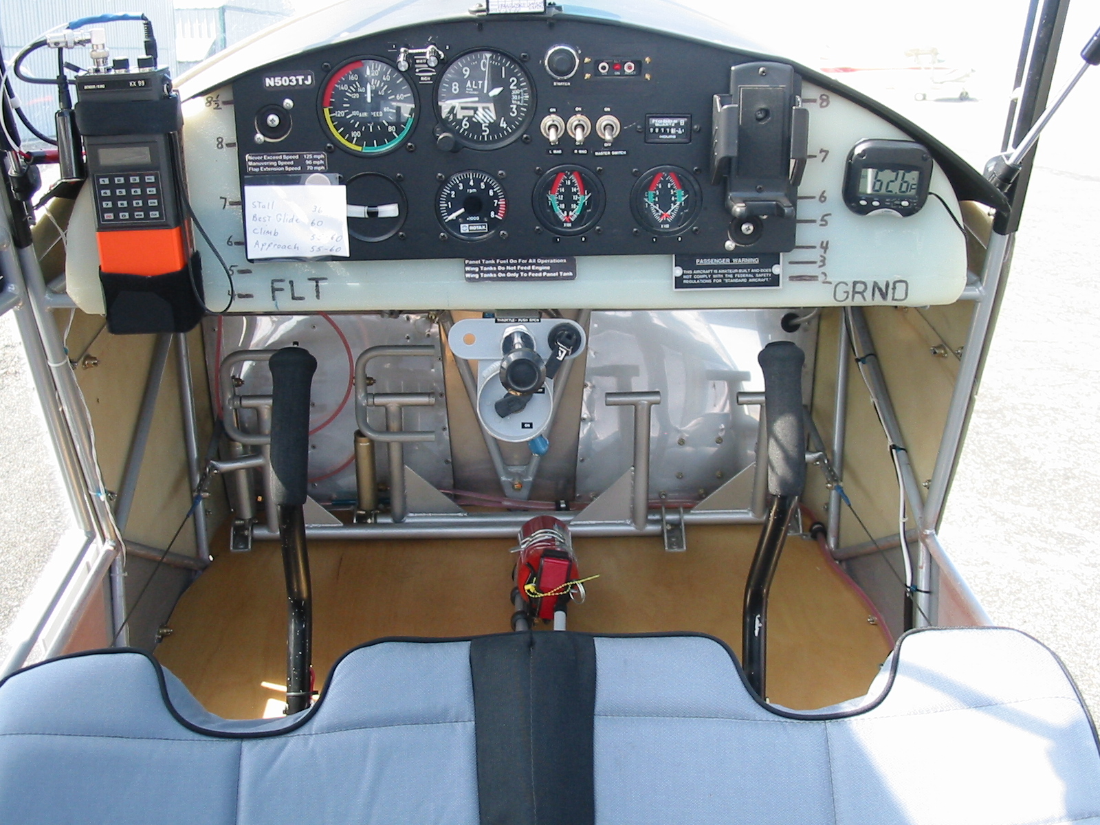

84KF panel pic attached....
I cannot take credit for the layout, but I find it quite functional.
The throttle was put on the left as the builder was ex-military and I guess he felt more comfortable with it there.

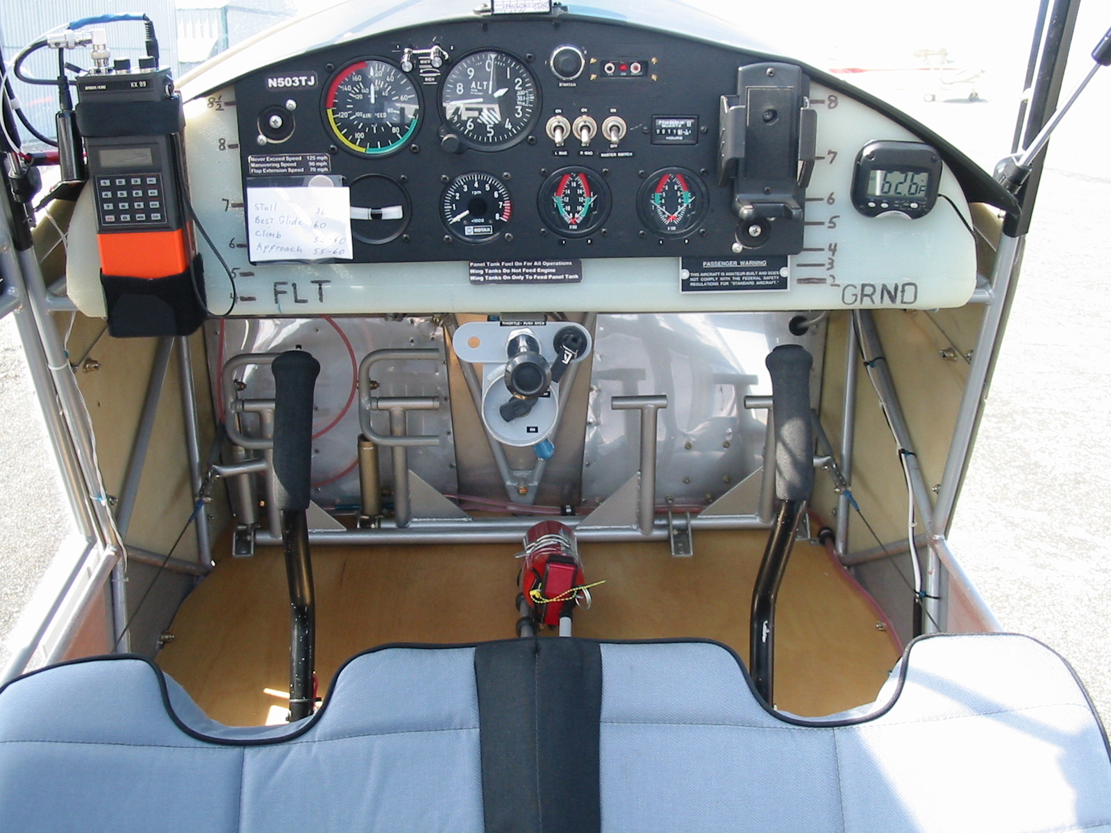

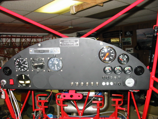

There is some very nice work progressing on those foxes. Here's a panel picture from the other end of the spectrum...just for a little balance for the basic folks.

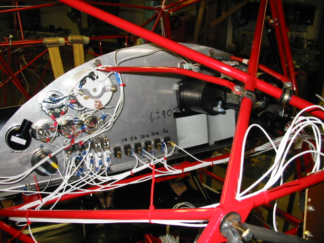

PostPosted: Tue Feb 05, 2008 4:15 pm    Post subject: Completed Kitfoxes Reply with quote

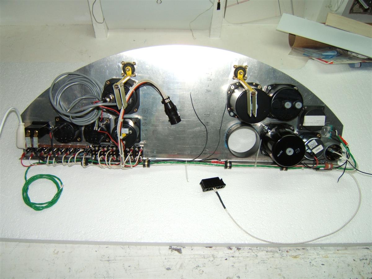

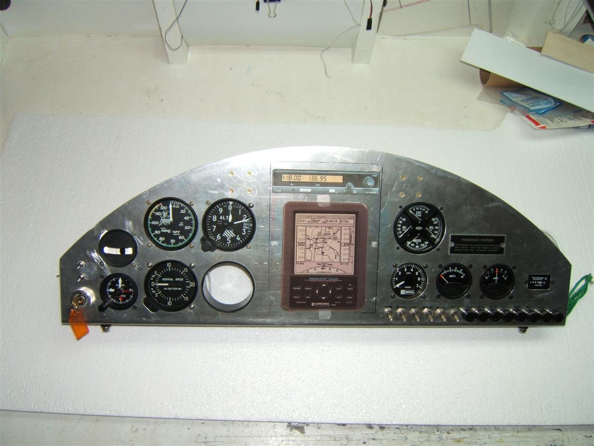

Here is a couple of pics on the panel in 205AK before radio installation

Simple,,but still an very nice panel..very clean..Steve Shinabery N554KF KF2

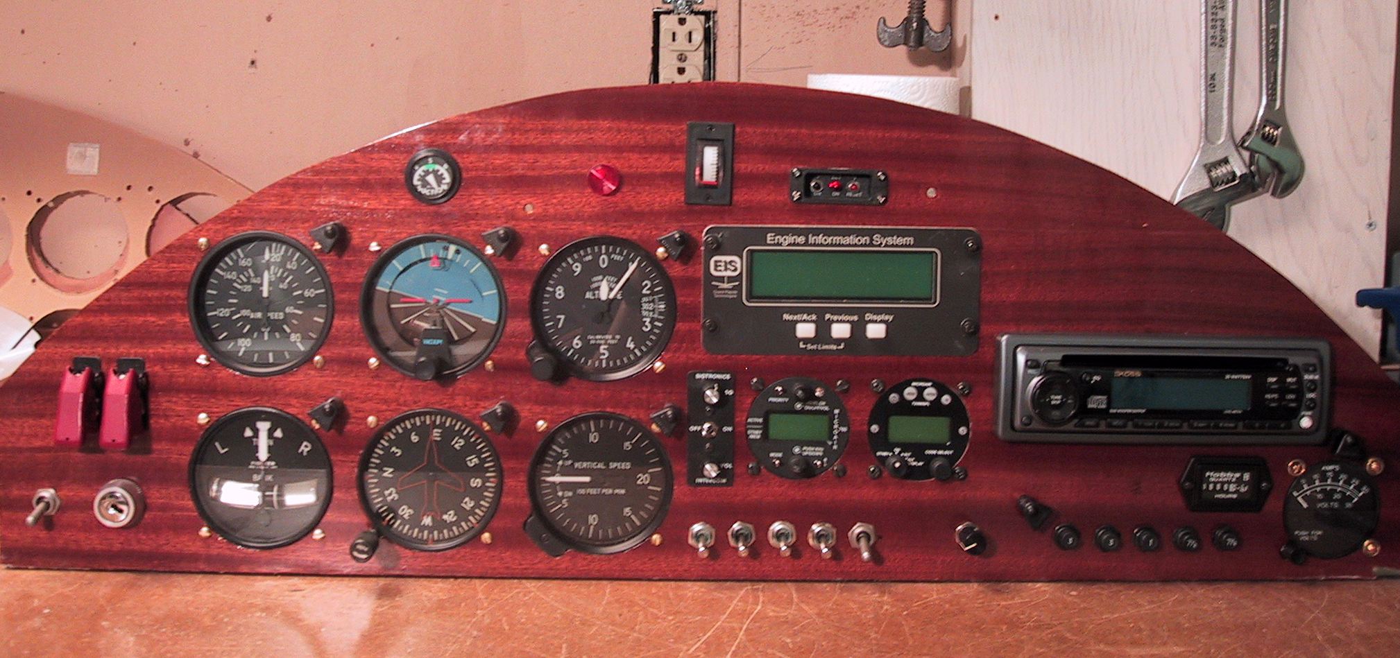

Good day all,
My panel is 'steam driven' .
I used Mahogony veneer and epoxy varnish (6 coats) for the finish.
Note the Post lights. I converted them to LEDs.
Electrical load on the instruments lights is 300ma.

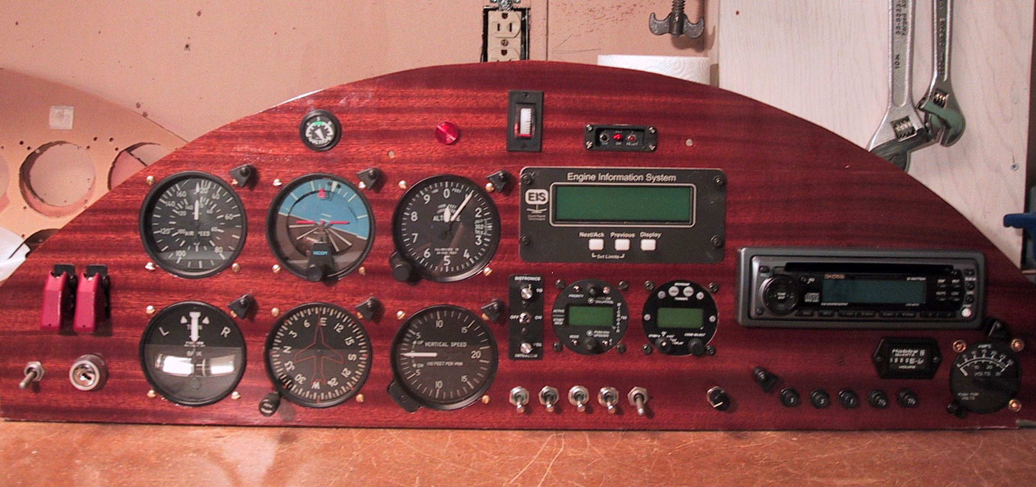

PostPosted: Tue Feb 05, 2008 6:13 pm    Post subject: Completed Kitfoxes Reply with quote
Good day all,

PostPosted: Tue Feb 05, 2008 7:26 pm    Post subject: Completed Kitfoxes Reply with quote
Doug, Panel looks great. What brand and model 3 1/8 inch gages and where did you get them? I need Alt. Compass, VSI for my panel.

PostPosted: Tue Feb 05, 2008 7:38 pm    Post subject: Completed Kitfoxes Reply with quote
Mmmmm.... drool!!! That is what I'd call a centerfold for "PanelBoy
Magazine". Very pleasing unto the eye.

PostPosted: Wed Feb 06, 2008 5:35 am    Post subject: Completed Kitfoxes Reply with quote
Doug, As an old woodshop teacher I can appreciate the work you put into that. nice job.
