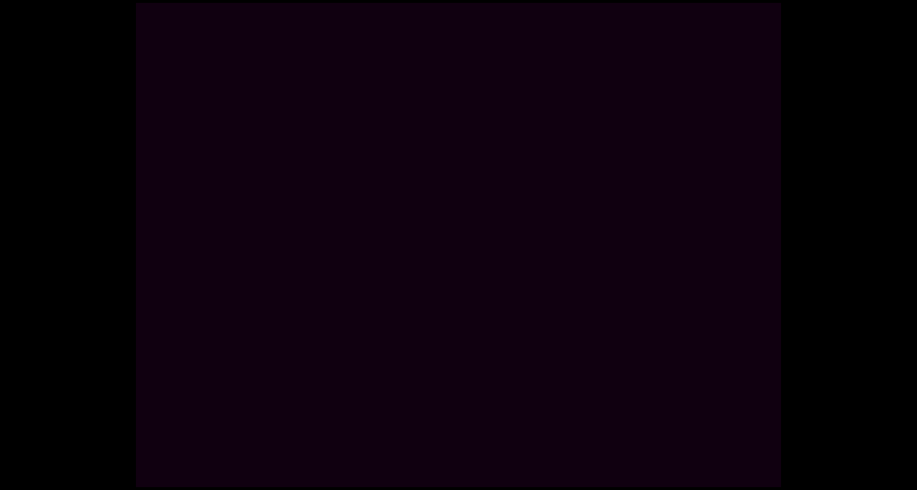

Thanks for the thoughts, Tim.
Probably anything Mark does will be better than what he has been doing. I'm
attaching a screen image from playing a digitized lesson segment with
Windows Media Player on my PC. The video file was made by sending the image
from a VHS tape to my Win TV box, and saving the digitized file on my PC.
As you can see, it's none too sharp. None-the-less, I can see out the
windscreen well enough to know where I am. And, since I know the panel very
well, and, since I can see the indicators on the altimeter, ASI, and tach,
I know what those readings are, even though I cannot read the numbers. I
can also interpret the AI images. The interesting thing is that Mark told
me that the images on my PC were the best he had seen from his setup.
Can he do better? Ya, lots. But he is not likely to pay much, so even this
quality, in a completely digital setup, would probably make him happy. And,
since he only charges $50/hr wet for his 150 and $30/hr for lessons, I
won't complain.
I would add that the videos were very valuable to me. More than once, I saw
my hands move the yoke on the video in ways that I would have sworn did not
happen. But, it's hard to deny the video evidence. And, on my
fly-monthly-to-keep-up-the-skills-while-building program, I always review
my "How to land this airplane" video before I go. Plus, I'm planning to
implement something similar when I get to my Phase I testing. I think that
the automatic recording of the panel and the audio will prove to be a
valuable, low effort, record keeping technique while testing.
So, the question is, what is a cost effective way to save low-to-medium
quality video for student's use?
