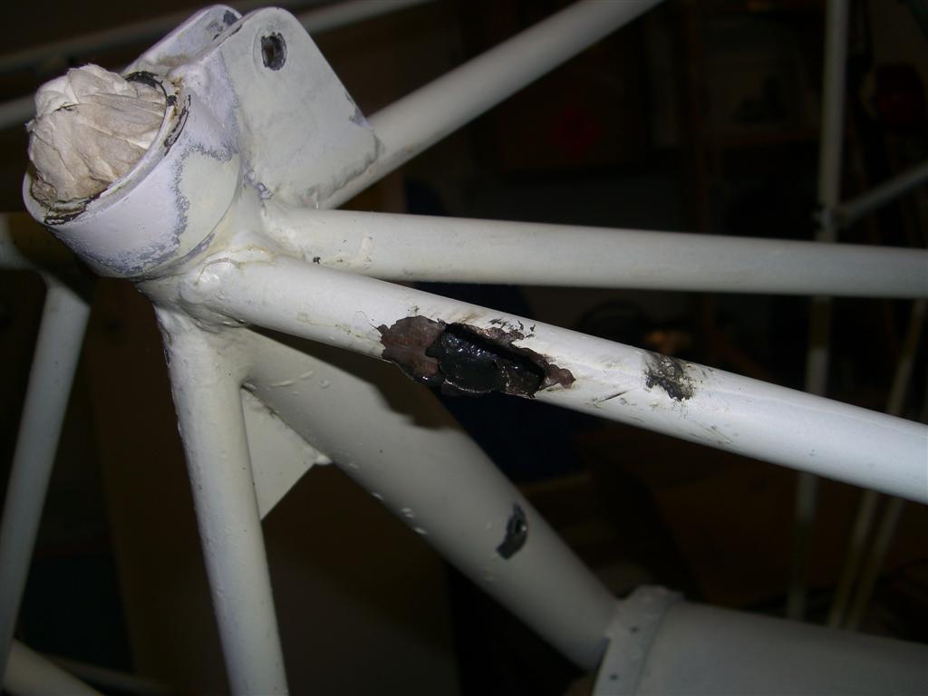

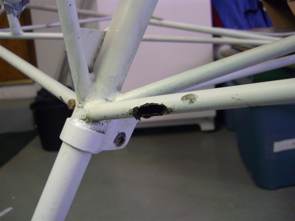

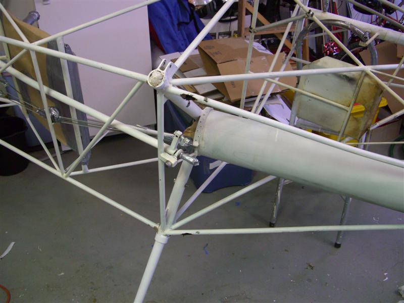

Today I was cleaning up the cage getting it ready to start painting it with primer. I found a rotted tube. It wasn't noticeable until I started wiping it down with a scrubbing pad. You can see it is wet inside the tube.
I had to test the other tubes as well and I didn't know how best to do it. What I did was I took a piece of aluminum tubing and started hitting the other tubes. When I came to the spot in the other side of the cage I left a dent so I know that side was weak as well. I guess that is a good way to test your tubing even if it is covered.
It was good to find it now rather then while landing.
So now I have two tubes that need to be replaced. Does anyone know what size and type of tubing I will need? I plan on bringing it to an aircraft repair shop but I would like to know the size in case I need to provide my own material.

So you can see what tubes are bad.

One method to use to inspect tubing for integrity is to use an awl or sharp pick and apply firm hand pressure with the point of the tool to the tube in question.
If the awl or pick penetrates the tube or deforms it, you have a corroded tube.
I would very carefully inspect all the lower tubes for corrosion as you may have other tubes that are in bad shape.
You will have to call Travis at Kolb to find out the wall thickness of the tubes that are damaged. The construction plans for my Firestar II do not specify tube wall thickness.

Looks like the result of no drain holes in the fabric, if left out with inadequate cover the moisture or rain settles in the low spot. Tube has to be replaced so you could cut through it and mic the wall thickness before you take it to be repaired. Aircraft Spruce will have what you need.

May have corroded from inside out.
Primary reason to use tube seal inside the fuselage and other 4130 tubes. Just cause you can not see it, does not mean it ain't rusting away while you sleep and fly.
The awl punch test will tell you when the tube is about ready to fail. Won't tell you anything about a tube that is rusting from inside out and not reached the point that the awl will penetrate the corroded tube.
I have been using one quart of Stitts Tube Seal for 24 years and three Kolb fuselages. Still have a pint left. Never had a tube rust through, yet. Wink

The tubes sure look like they rusted from the inside. The outside of the tubes looked normal. I like the tube seal idea after seeing these tubes. I received some encouraging emails and after thinking about it I guess it isn't so bad. I'll have it fixed in no time. I couldn't have found it at a better time.
