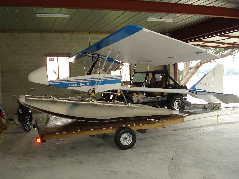

Did it for a year Check out June 05 Sport Pilot for a full story

Kolb's have the best folding tail in the industry. Fold the plane as normal

Firefly 007/Floats
