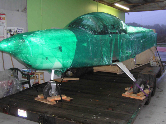

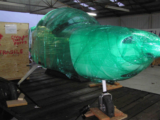

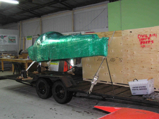

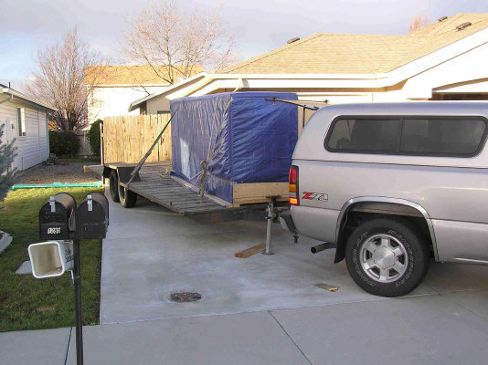

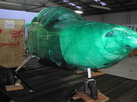

aprazer
Joined: 24 Nov 2006 Posts: 93 Location: Boise, Idaho
Posted: Wed Jan 02, 2008 11:20 am Post subject: Trailering |
See pix for a suggestion!
I successfully pulled this close to 700+/- miles at freeway speeds -- 75+/-
across Nevada.
Did slow down for the bad winds that were encountered!
Mack
601XL/3300

aprazer
Posted: Fri Jan 04, 2008 9:52 am Post subject: Re: Trailering |
Gig, Andy and Amy;
Amazing uses!
I have forwarded your suggestions to Saran Wrap for consideration and possible implementation!
In today's economy, corporations need to diversify -- prior to reaching the principle of diminishing returns!
BTW, my bird was snug, warm and DRY during transport!
Mack

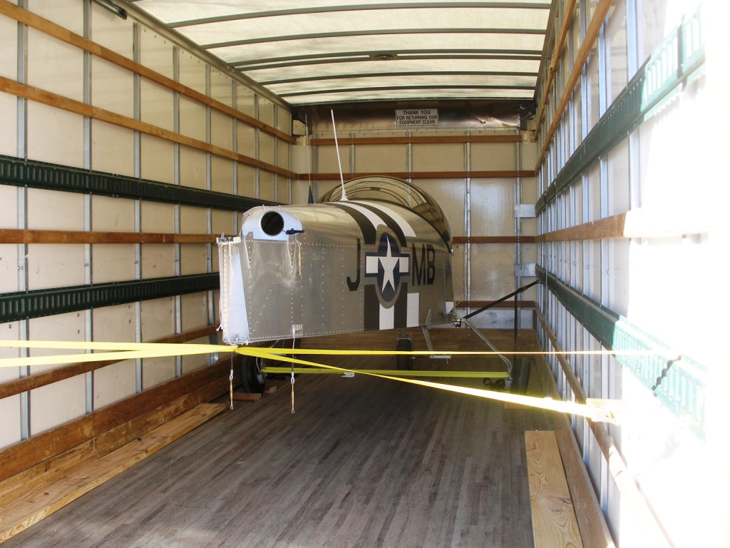

That trailer looks ideal. I just couldn't find one like it. I wound up renting a 24' straight frame trailer with a hydraulic loft gate. We had th squeeze the main gear about 3" with a ratchet strap to get both wheels on the lift gate. The photo is not a great one, but it got a little too busy to be taking photos. Made the 35 mile trip in 1 hr., 20 min., with no damage.
Thanks, Jay
