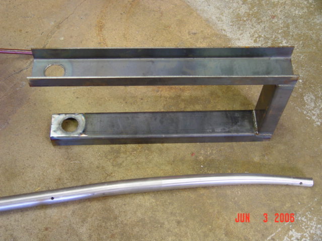

Hello all,
I remember seeing a picture of a jig someone made for straightening bent aluminum gear legs. Unfortunately, I have found myself in need of such a device. Anyone know where to find pics or plans??

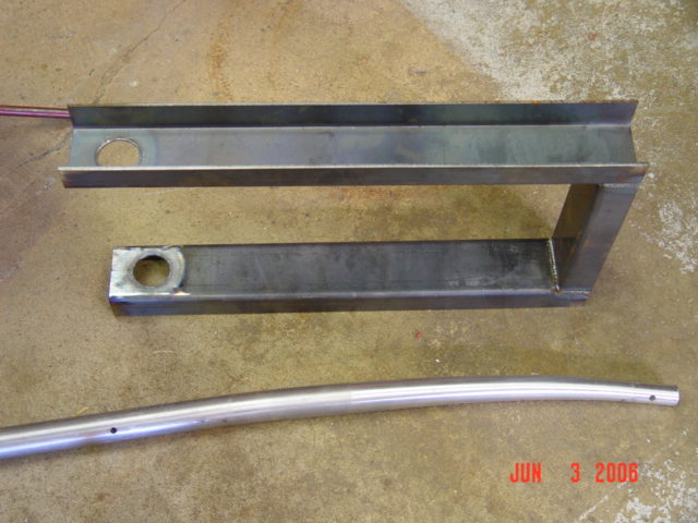

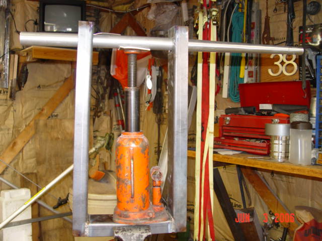

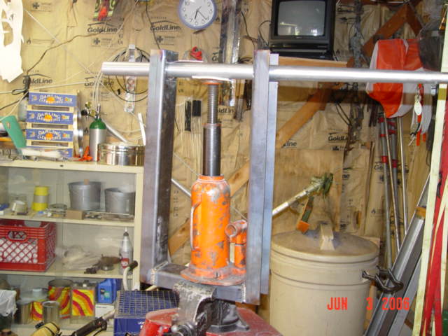

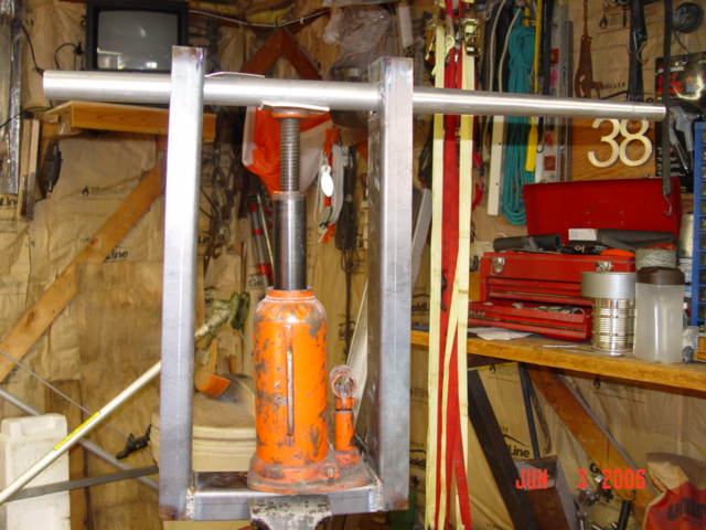

Bryan,
I can't remember who posted these... It was not me... but I had to straighten my gear too, so I picked up these photos from the list.
Good Luck!

PostPosted: Wed Dec 26, 2007 7:07 pm    Post subject: Re: bent gear Reply with quote
Hey, That's my "Quick" press...
I stopped over somebody's house on my way home with my gear leg...
I was going to use his "press".....He wasn't home.
So I Slapped this thing together....it Worked great...
and I haven't needed it again !
Gotta Fly...
Mike & "Jaz" in MN
PS It was a 12 ton jack
 Filesize:  59.87 KB
 Viewed:  620 Time(s)
Gear looks fine now....

Thanks guys!! That's the pic I remember.

If I had two of those legs bent the same I would turn them upside
down (rotate 180)
and use them that way.
I bent one leg on my second flight when the poorly tuned carb starved
the engine
at 50' on short final and I had to dive it to save what I could.
Used my neighbor's press.
-Then I saw Harbor Freight had a sale on a hydraulic pipe bender and
bought one.
Haven't had to use it yet.
BB
