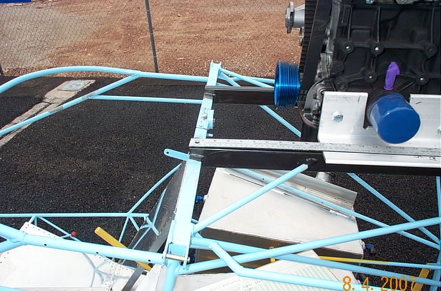

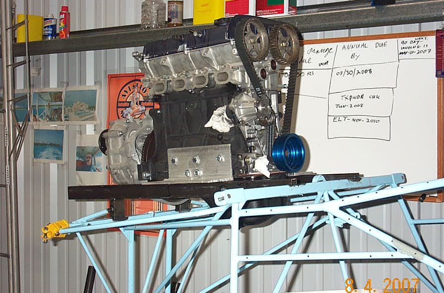

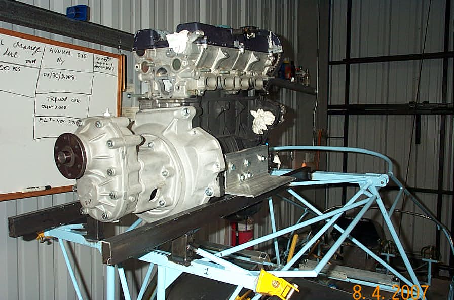

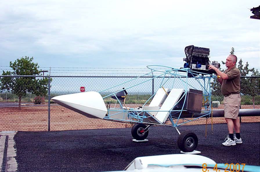

I think I am going to name my airplane the apogee, seems like a name that may help me to get it to fly. anyway here are some pictures. I had some others, however,,,,, I decided to upgrade my Mac to the latest OS called Leopard and it obliterated the iPhoto program. I can't find the pix from yesterday. They are in the camera so not lost. I'll try uploading them from the HP, maybe tomorrow.
these are attachments so they should not slow anyone down.
Ron

On the last picture ....I was looking at the "Nose cone"
Is it mounted at "THAT" angle ??????
Gotta Fly..
Mike & "Jaz" in MN
captainron1(at)cox.net
PostPosted: Sun Dec 23, 2007 10:25 am    Post subject: per request some more pix of the M3X Reply with quote
Smile
Hi Mike
I have gotten more than one question about it... laughing. The cone is held in place by friction alone. Right under the main gear in the pix there is the bathroom scales. I was weighing the frame and the motor for W&B in different positions. I was sliding it back and forth to get a rough read on the weights. The nose cone is not fastened at all, and in fact its now back occupying its dust outlined space in the hanger. Smile
But you people are giving me an idea for a tilting nose under control as a form of a canard!!!!!! laughing. that dude is bottom flat enough to in fact provide lots of control authority, some winglets and some antennas on the sides will make it look like a cat fish swimming in water.
But that is on the back burner as well, till I finish it.
Ron
Arizona

See, Ron, it wasn't just me that thought it looked a little odd. Mike, I already asked Ron about this, and he said it was just "hung" on, not mounted.

Ron .....it looks like you have changed the engine thrust line quite a
bit from the standard set-up . Do you think that will be a problem ?
Bill
PostPosted: Sun Dec 23, 2007 4:56 pm    Post subject: per request some more pix of the M3X Reply with quote
I kept true to the original mount angle. The rear is lifted to about the same hight angle as the original single tube mount. The thrust line profile angle is the same. The motor may sit lower but that's because the mount cradles the motor and its not sitting as high as the factory mount. Which is good, taking the thrust line lower should reduce the pitch down force when applying power. But !!!! when fully installed it may sit identical to factory hight since the shock absorbers are about an inch thick and then the brackets on top of that are another .5 inches. We shall see.
Ron
Arizona
