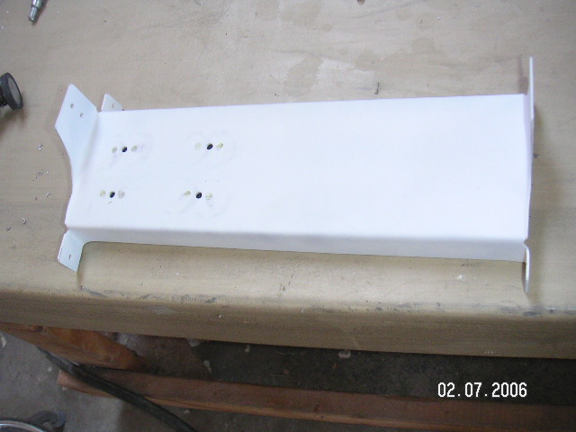

jwadejr(at)direcway.com
PostPosted: Thu Feb 23, 2006 9:04 am    Post subject: New builder dumb question re Autopilot install Reply with quote
I built mine and mounted after cabin was on. I am installing Blue Mountain. Built mount for aileron and elevator. Installed aileron mount just before closing bottom skin.
Jim
40383

rick.conti(at)boeing.com
PostPosted: Thu Feb 23, 2006 11:05 am    Post subject: New builder dumb question re Autopilot install Reply with quote
Jim,
Where did you install your aileron mount?
Thank You
Rick Conti
PostPosted: Thu Feb 23, 2006 1:27 pm    Post subject: New builder dumb question re Autopilot install Reply with quote
Right wing in the bay the aileron push rod ends. Here's a pic of the mount I built. It rivets right to the ribs.
