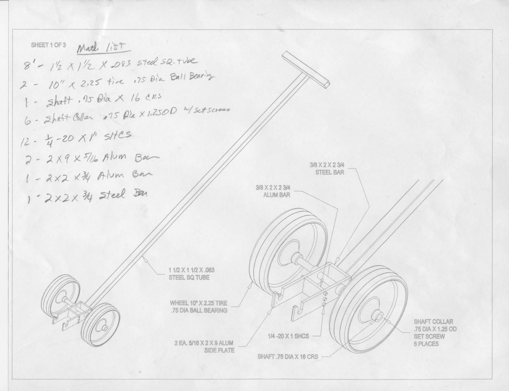

Agreed the Tail Dragger Dragger might work ok on asphalt but it does not work well on grass. Here is my experience with it.
I have to push the dragger up under the belly by going quite a bit up forward else the wheel doesn’t fit under the back of my -6. Then pull it back to get it to the tail wheel and it wont really just slide to get the tailwheel between the pins so usually I end up picking up the plane slightly to set it on the dragger. Hard to do with only two hands. Then when I try to pull it backwards on the grass the wheel tends to want to turn in the saddle. This is especially true if you need to turn the dragger to position the plane differently. Once the wheel turns in the saddle, it will pop off the dragger and be a bad thing. To fix this I use a bungy cord to wrap around the wheel and the dragger and hook it to the pins. Well you can’t just go under the dragger with the bungy so again you have to lift up on the handle while stretching the bungy under the bar so you can bring it over the top of the wheel again to hook it.
Overall I have deemed it next to useless for my needs and would be willing to sell it to someone with asphalt only needs. Personally I wouldn’t buy one again even if I was on asphalt. An engineer friend here on the airpark designed a simple and easy to use with positive connection for his Sonex. After seeing how easy it was it looked to me like it would work for my RV. He has redesigned a version for me and this works about as perfect as it could. Now I just walk this back up to the rear of the tail wheel and tip the handle up and push it in. Once under the wheel bolt, let the handle down and you have a positive lock on the wheel and it will NOT turn out, pop off or even require me to get down and screw around with it. I love it and am absolutely willing to share the design. Problem is you have to build it.
If anyone is interested, just email me and I will scan the detail drawings in so you can see for yourself.

PostPosted: Wed Dec 19, 2007 7:34 am    Post subject: Tail Dragger Towbar Question Reply with quote
Here is page one for viewing. If you are interested in building this just ask me off line and I will send the other two detail drawings.
