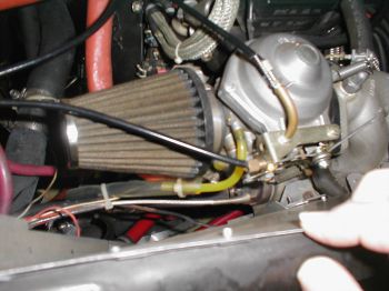

Tommy Walker
Joined: 12 Jan 2006
Posts: 442
Location: Anniston, AL 36207
PostPosted: Sat Dec 22, 2007 4:08 pm    Post subject: Re: 912ULS: Carburettor and Airbox venting lines Reply with quote
Roy,
Do you have a picture of your vent line setup that you could share?
Many thanks,

PostPosted: Wed Jan 02, 2008 2:47 pm    Post subject: Re: 912ULS: Carburettor and Airbox venting lines Reply with quote
Tommy,
Here is a photo of one vent line going into a larger line in my plane. I drilled a small hole in the top of the larger line near the end of the original length Rotax vent line, just to be sure the vent sensed the local pressure.
(Sorry for the delayed response, I've been away for the holidays.)
Happy New Year
Roy

PostPosted: Thu Jan 03, 2008 12:03 am    Post subject: Re: 912ULS: Carburettor and Airbox venting lines Reply with quote
Roy, thank you for sharing the photo of your venting line and your information about routing of the line.
Happy new year to all of you!

PostPosted: Thu Jan 03, 2008 3:54 am    Post subject: 912ULS: Carburettor and Airbox venting lines Reply with quote
Roy,
Thanks a lot. I got the pictures and from what I can see you have a well put together engine. Does the larger tube run down to the slip stream?
Tommy Walker in Alabama

PostPosted: Fri Jan 04, 2008 6:43 pm    Post subject: Re: 912ULS: Carburettor and Airbox venting lines Reply with quote
Tommy,
I ran the larger tube to the bottom of my engine mount, close to the firewall attachment. The tube does not extend below the cowl.
Roy
