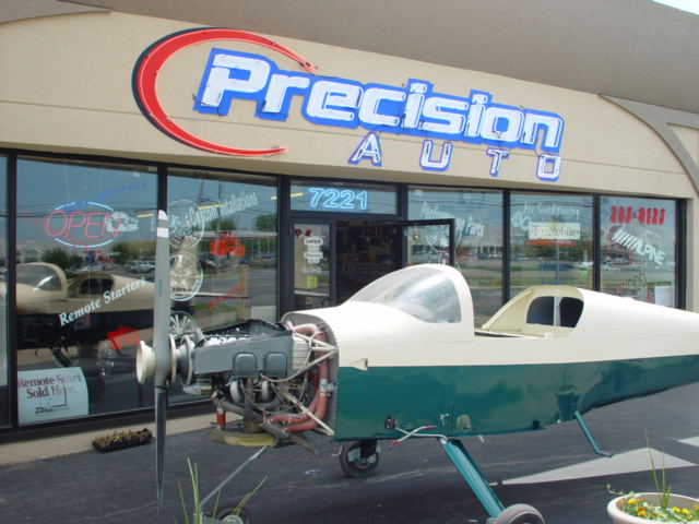

PostPosted: Thu Dec 13, 2007 2:44 pm    Post subject: Cost of Paint Job Reply with quote
Heres a pic of my 6a getting painted at my shop. I parked it in front during the day to showoff but had to move it because it caused a few accidents with the traffic out front. Any quality auto paint shop can do a great job. Just pull the wings and flatbed the fuse. I did mine in basecoat clearcoat because the painters were most familiar with that system. I think I have 500-600 in materials and 20hrs of shop time.

made arrangements to work at a friend's hangar at an airpark. I
proceeded to take the whole airplane apart and set up a paint
booth in a Costco car tent in my back yard. I bought a big
compressor and a DeVilbiss FinishLine 3 HVLP gun. Based
on Randy Lervold's recommendations, I went with PPG Concept.
I washed, acid etched, scuffed and alodyned all the aluminum. I
spent a lot of time on the fiberglass and used almost a whole gallon
of K38 high build primer, most of which ended up on everything
in my shop when I sanded it off. I also used quite a bit of
SuperFil. I started painting the color coats with white Concept.
It wasn't great, but it wasn't horrible either. Had the usual
problems with dust, runs, and orange peel. There is a real art
to putting on the final coat. You really can't sand very much
because you will cut through a rivet or just a high spot on the
aluminum. When I painted the empennage fairing with a dark
blue, I kind of lost it. The one piece had orange peel, runs, and
dust everywhere, even with fans and filters. I decided I couldn't
do a job I would be happy with. I went back to the shop who
quoted $10,000 and asked them how much just to put on
the color. They said between $3000 and $4000. Based on
really good review from a person I trust (Terry Burch), I decided
to go ahead an do that. I brought the pieces to them in
sanded primer/sealer. They had to spray a coat of primer and
then basecoat clearcoat. I ended up eating some Concept,
but that's the way it goes. I spent upwards of 200 hours
over the summer doing the prep and priming. I know it's a lot
of hours, but there is a lot to do, especially with the fiberglass
work. There are a lot of pin holes and they will show up if
you don't totally take care of them. I had one of the very first
S type cowls, and it was rough in places. I ended up spending
about $3000 for materials plus $3800 to the paint shop. This
doesn't count the compressor, paint gun, tent, lights, fans, etc.
Plenty of people paint there own airplanes, and I admire them
for it. It is a lot of work. I took my plane down in late April
and didn't fly again until September. In hindsight, I really
wished I had just bit the bullet and had the whole thing done.
That is one person's opinion. Your mileage may vary.
