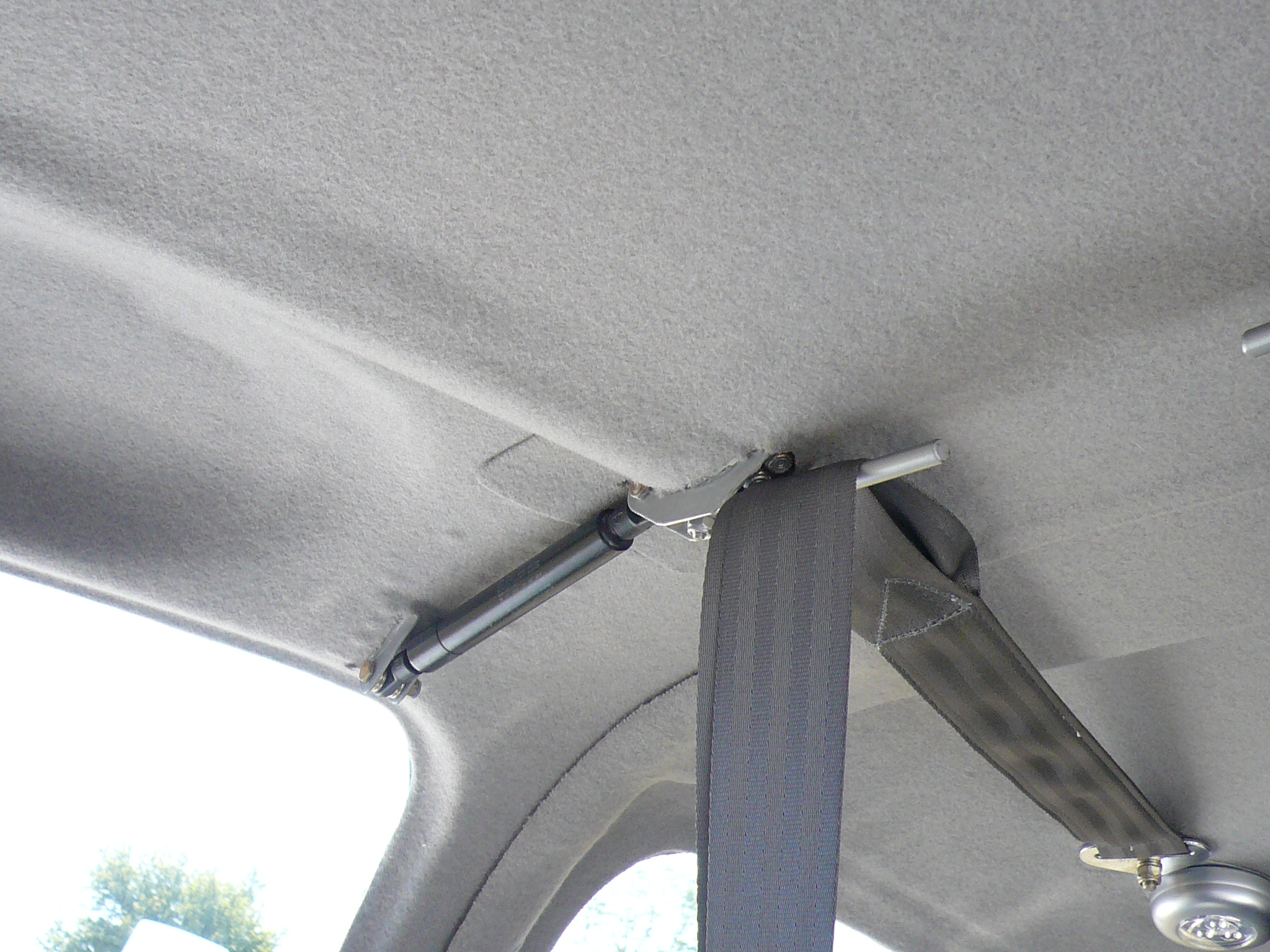

I thought that this was a rather elegant solution for the dangle phenomenon.
These guys at OSH had a good solution to the belts plus they had these neat battery powered LED lights that they got at Wal Mart for $7 Very Happy
seat belt holder

Cool, I didn't know anyone else saw my LED click-lights and
copied them. I think that they're an excellent way to go.
I put them in last March and think it's a great way to get
lighting in the plane for those without the overhead console.
http://www.myrv10.com/N104CD/upgrades/20070321/index.html
Not only that, but it is independent from the electrical system
so in a pinch you have light to work from. I added one in the baggage
area too.
The seat belt hangars look good too. I'm hanging them from the
more common location that I stole from Randy, from brackets
mounted under the door hinges, but it's really the same
basic theory. Jesse covers his in Leather which is very very
nice. I used a little too thin aluminum, so I'll probably
re-work mine some day. When you hang them though, they're
out of the way pretty well, and easy for you to reach to
put on.
Good stuff.

Those are some great seatbelt hanger designs in that pic by BS Aviation.............seen that plane a few times. Smile
DEAN (trying to get to Steinair)
