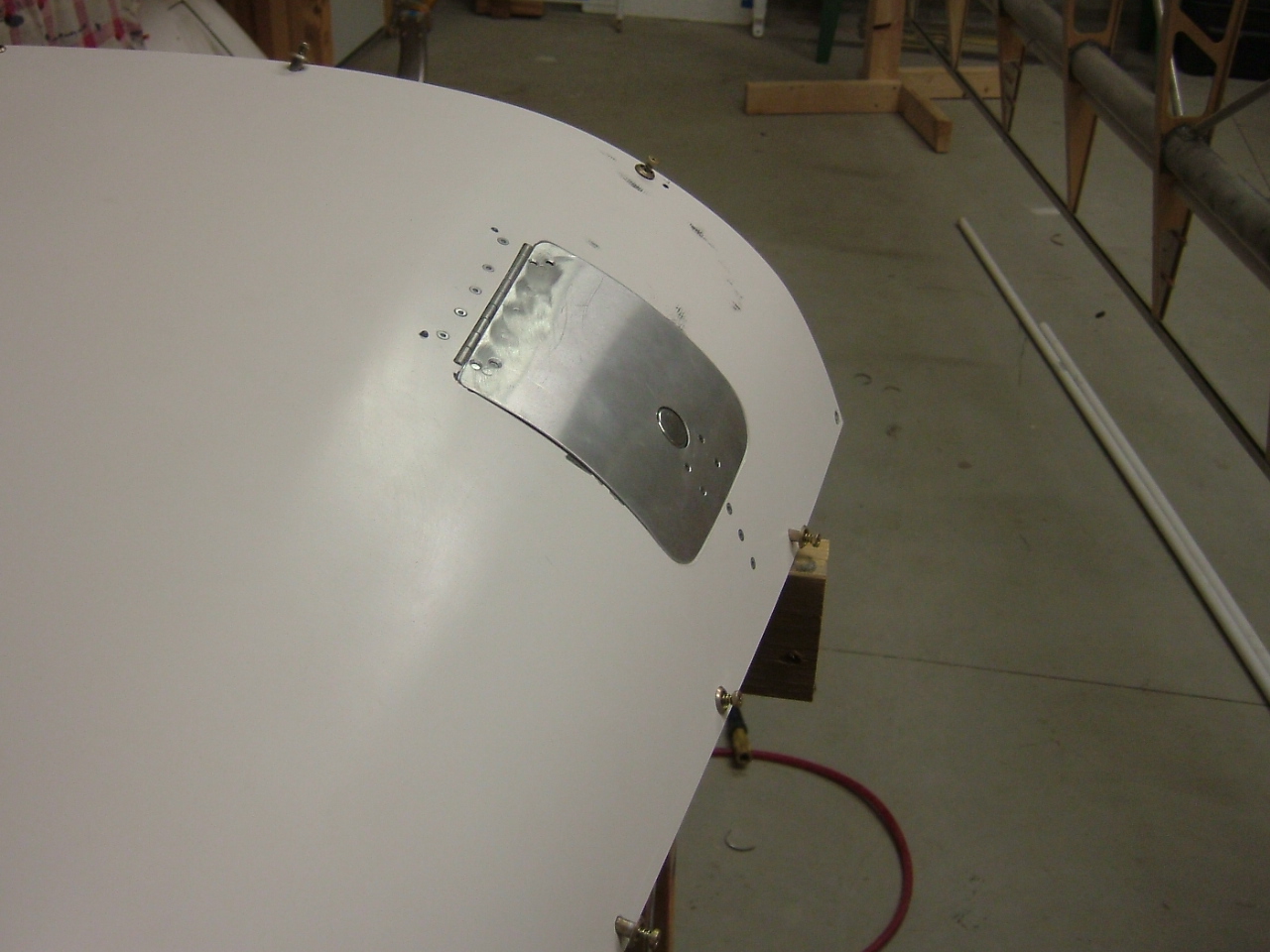

I have one that was installed my model 2, I think it once was an option
from Skystar so not available that way. Perhaps John McBean can advise.
Mine is nothing more than a standard access door from some manufacturer
that came with instuctions on how to cut out the cowling and install.
It's flat and does not match the curve of the cowl, but it works well.
If you could find a source for a suitable door it wouldn't be too hard
to figure out the installation. I'd be happy to take pictures of mine
and copy the instructions when I get home Sunday.

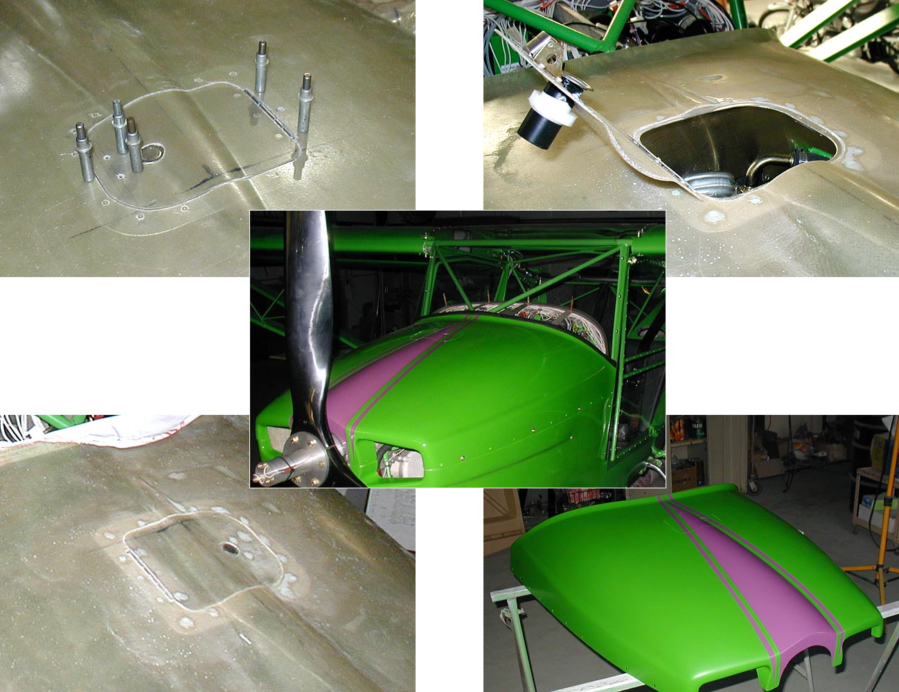

darinh
Joined: 20 Apr 2006 Posts: 327 Location: Utah
Posted: Wed Nov 28, 2007 6:51 pm Post subject: Re: access cover for oil |
Jerry,
The Series 7 has a molded impression for the oil door which is cut out and an aluminum cover is hand bent to shape and installed with an aluminum piano hinge. The Kitfox manual has you secure the latch using winged camlocs but I like the flush latch closure better. If your cowl doesn't have the molded impression, simply fabricate a latch cover from a piece of aluminum that is the same thickness as your cowl then bend it to shape. Once you are satisfied with the shape, you can place this cover on the cowl and trace it. Then carefully cut and sand/file the opening to shape allowing for a 1/16 clearance on each side. Then glue and rivet strips of aluminum under the cowl for the latch to rest against and finish the install by gluing and riveting the piano hinge on. The piano hinge knuckles will require a bit more than 1/16" clearance so trial fit this and trim as necessary. See my installation for ideas. This is a good, functional installation and looks good to. Hope this helps.
| Description: |
| Filesize: |
447.75 KB |
| Viewed: |
441 Time(s) |
| Description: |
| Filesize: |
397.44 KB |
| Viewed: |
439 Time(s) |
_________________ Darin Hawkes
Series 7
914 Turbo
Kaysville, Utah |

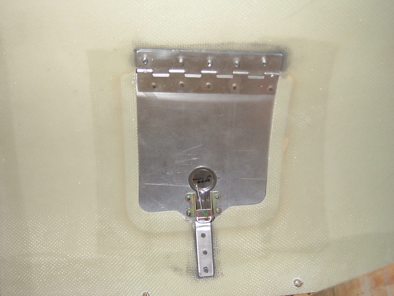

MichaelGibbs(at)cox.net Guest
Posted: Wed Nov 28, 2007 7:32 pm Post subject: access cover for oil |
As Guy said, the piece you cut out of the cowling makes a perfect
door, there's no need to fabricate one. On my Model IV I had to put
the opening directly in the center to align with the oil tank and it
would have been tricky to precisely bend a piece of aluminum to the
shape of the cowl which had a ridge down the middle.
I cut an aluminum frame to go under the opening to act as the stop
for the door and to reinforce the fiberglass. A piano hinge, a flush
latch, and some filler were all that was needed to make for a very
functional and attractive installation.
Mike G.
N728KF
Phoenix, AZ

Fox5flyer Guest
Posted: Thu Nov 29, 2007 4:16 am Post subject: access cover for oil |
Nice display Mike. Worth a thousand words.
Deke
NE MI, S5
