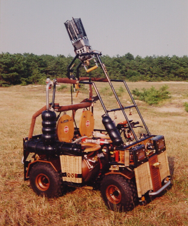

Ironic, but I now find a compass useful once in a while for navagating
balloon out of wilderness!

Now, that is my kinda gondola. I particularly like the comfort stations. However, will that puny little burner actually get the bag light enough to lift the Gondola? How about a full blown quadro instead? And, how big a bag? I doubt if my 55,000 footer would have budged it before it melted!

Hi Bob
"> However, will that puny little burner actually get the bag light enough
to lift
| Quote: | the Gondola? How about a full blown quadro instead? And, how big a bag?"
I build that puny little burner in 1985. I needed something light when
driving. It uses 36 feet of Inconel 600 3/8" .035" wall. "IT IS 30,000,000
BTUs!!!". On in other words ~ 7,500 hp (converted BTUs to calories then to
HP). Compared to a 10,000,000 BTU Raven RX-6 burner that uses 1 pound in a
4.3 second blast, this beast uses 3 pounds in 4.3 seconds! Notice it locks
in position for ground ops. Even compared to todays standards, it is right
there! Very blue flame, tight and I adjusted where we can't hear a lot of
noise (used 13 strategic adjustable aim jets, dogs sure can hear noise!
Had a Golden Retriever (wanted to change heritage to balloon retriever)
when would shoot burner would go into bedroom closet and not come out!)
Envelope is 95,036 cubic feet (weighs 236 lbs) Big "8" ball
The closest thing at the time, a Honda Oddysey weighs in at 450 lbs
without any provisions for tanks, burner and associated things to fly, and
only carries 1 person. "Screwball" weighs in at 140lbs drivable (22HP 6
speed) and carries 3 people (can hang 1 person from top of balloon!)
Flight ready with 31 gallons is 600lbs.
During certification I loaded up balloon trailer and lifted 2750 lbs.
Usual like to fly 15 pounds per thousand, flys OK even at 20, at 30 its a
dog. Have had a 7 hour and 15 minute flight with a pretty heavy take off
weight. Real drag having to carry tank-age when empty.
Ron Parigoris
NJ8AX "Screwball" Balloon has 4 wheels and flies
N4211W Europa Monowheel (work in ProgMess) has 4 wheels and flies
Garbage trucks too have 4 wheels and flies

Good Evening Ron,
Absolutely fabulous!
A lot has changed since I had my Raven!
