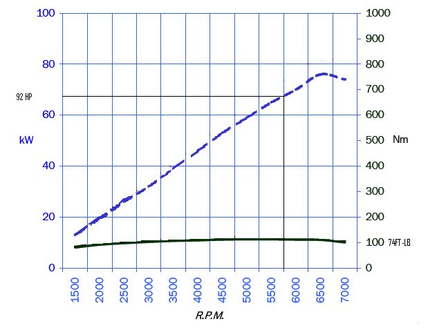

RE: 90hp
I just found this Dyno curve last night for the G13B. It is of a stock 1.3l GTI/GT injected but not turbo-ed engine. I don't know what Raven does to the engine, if anything, but stock for stock it appears to compare very nicely with the 912S for a lot less!
Kevin
