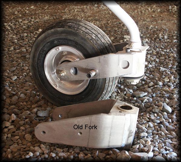

PostPosted: Wed Nov 14, 2007 3:48 pm    Post subject: RV Nose Gear SB Question Reply with quote
The relative mounting points are the same as the old fork. The fairing should fit the new fork without modification.  The attached photo of my gear (which was posted earlier by someone else) kind of shows that.

That was me Bob, Smile I have been wondering where that picture came from for months! It's in my RV "This explains it all" photo section but I never remember where they came from! No matter if anyone decides to make the change or not,..... the picture makes it pretty obvious why it isn't a bad idea!
Bill S
