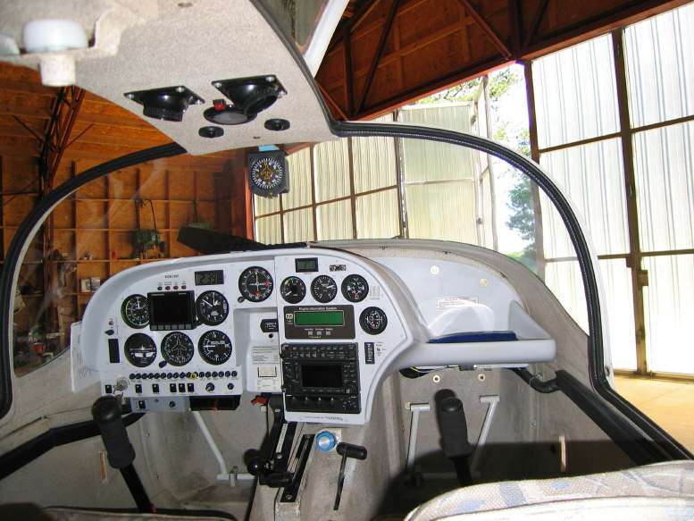

Hi Paul,
See my set up for a vertical card compass http://www.aircraftspruce.com/catalog/inpages/vertcard_compass1.php in photo below. It is supported on an aluminum plate which is secured to the cabin top frame. You will also need the mounting bracket http://www.aircraftspruce.com/catalog/inpages/vertcard_compass2.php Anyway, it works for me and I did not have to apply any compensation. Vertical card compasses are worth the extra money in my opinion since they are a bit easier to read than the standard 'whiskey' design. (See the blurb.)
Chinese 'copy' compasses are available from Falcon gauge but I preferred to spend the extra for the original. Please contact if you have any questions.
Cheers, John
