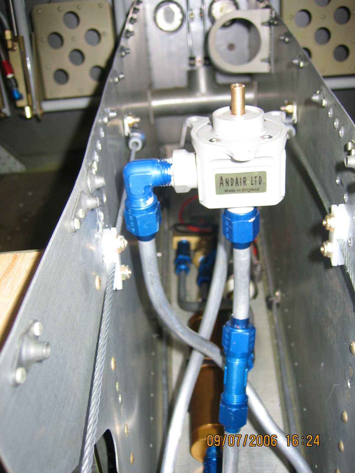

Just a point for those considering Andair valves. Make sure you get the right version and best orientation.
I’ve seen plenty of discussion about the extension handle creating room for the scat hose, but an even better reason for lowering the assembly has a lot to do with some of the initial problems with the early edition valves, location and the orientation.
In the photo attached, when the valve is centrally located, it has the potential for the rudder cable to saw through the fuel line.
