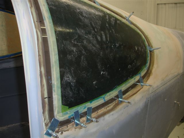

If you don't want to use Sika-Flex or Weld-On, try using 3M 2216 Structual Epoxy. I use this stuff everywhere, even on my RV8 that is 7 years old and has over 1100 hours on it.
I installed my Rv10 windows, NACA ducts, Rudder Cable Fairings etc... with this product. I was trimming around the interior windows with a razor and it slipped and put a nice gouge in the window. I tried to polish the window scratch out to no avail.
Ok. I neeed to replace the rear window. Got a chisel out and started to try and pry it off. No luck. Started tapping the chisel with a hammer. Nothing.
I finally smacked the plexi with a hammer to beak it and create a place where I could stick my chisel in and pry the plexi off. The plexi was "welded" on to the fiberglass! I had to add heat from a heat gun to persuade it to come off.
Long story short....use 2216 epoxy for your windows if you want. It works, has a slow cure time so you can work a little easier. Does not need a "primer". Just rough up both mating surfaces with 40 or 80 grit. I forgot to mention that I thicken up the epoxy with some 407 or 406 Colloidal Silca from West Systems so it does not sag. Cool stuff.
And one more thing....Be careful with razor blades around your plexi.
Zack
See pic below...
