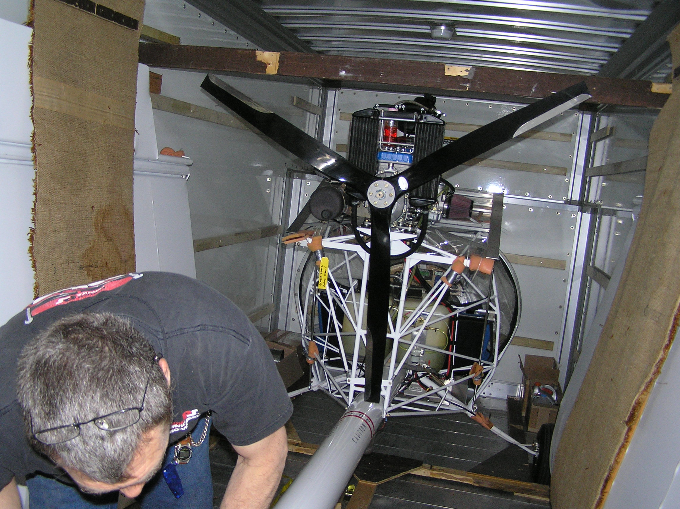

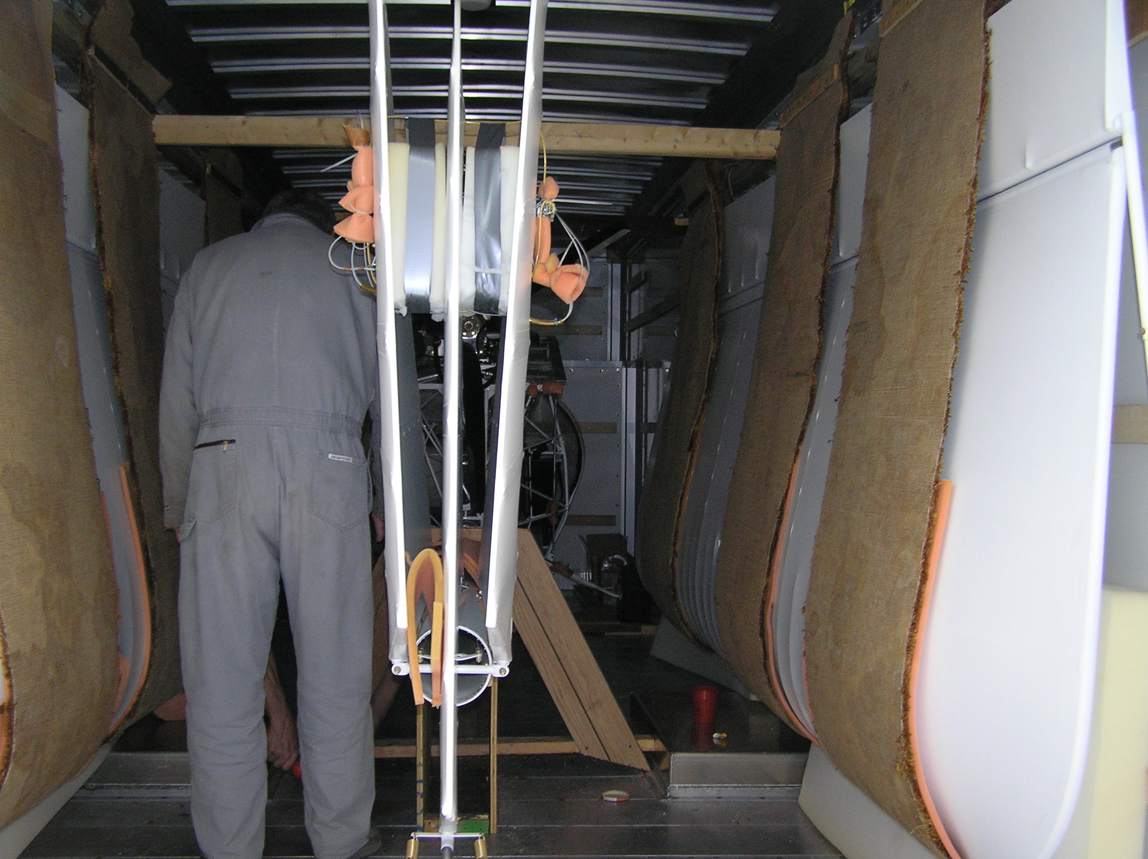

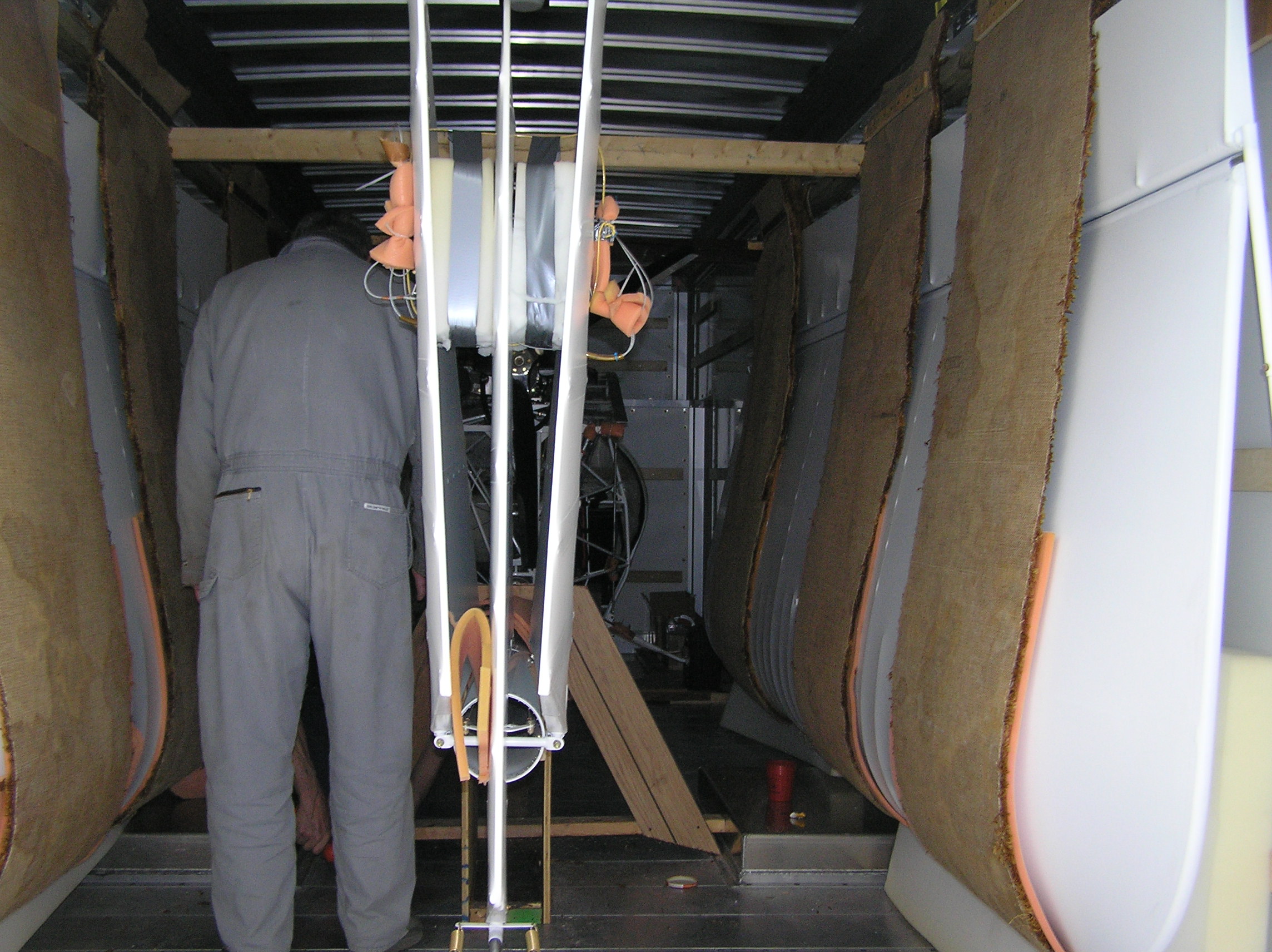

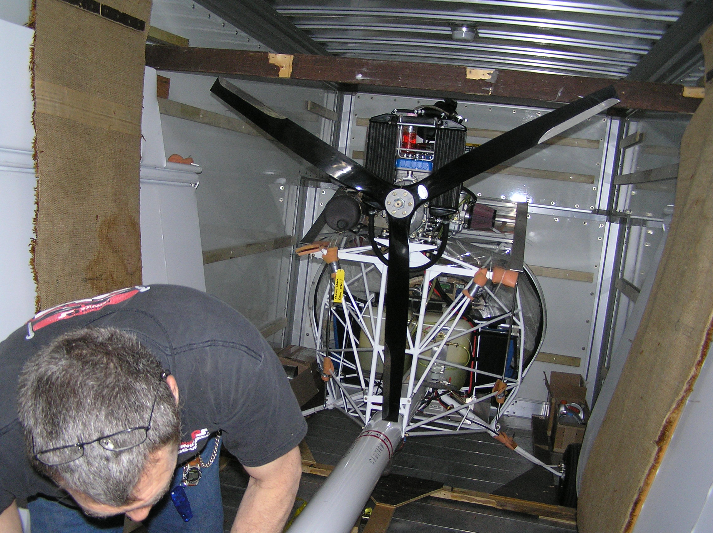

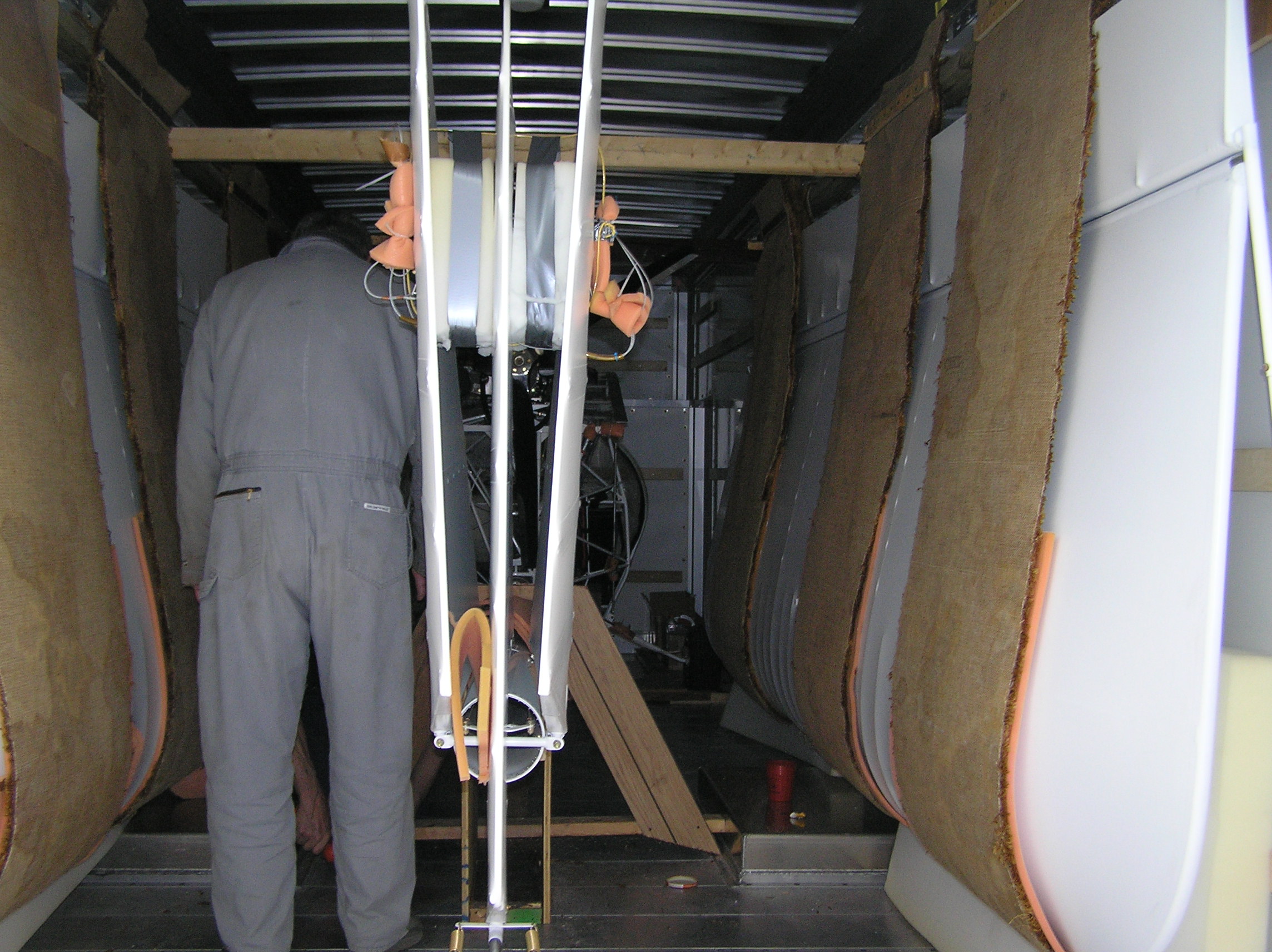

I brought my MkII home to PA from Northern Wisconsin in a 28' rented U-Haul. And a detour down to Dayton so I ended up with about 1300 miles on it. When I unloaded I hade absoulety NO hanger or trailer rash. Attached are some pictures of how we rigged it.
 Filesize:  816.66 KB

 Filesize:  662.56 KB
 Viewed:  726 Time(s)
 Filesize:  845.63 KB
 Viewed:  779 Time(s)

PostPosted: Thu Oct 25, 2007 4:17 am    Post subject: Re: Trailering a Kolb Reply with quote
For some reason I could only get one image to attach. So here is another one. Wings were hung with foam, carpet and 1" nylon safety straps. Wheels chocked and boom put on a rest.
 Filesize:  845.63 KB

PostPosted: Thu Oct 25, 2007 4:20 am    Post subject: Re: Trailering a Kolb Reply with quote
Last one. That's me on the left and Dick Neitzel, builder, on the right.
