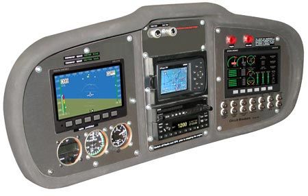

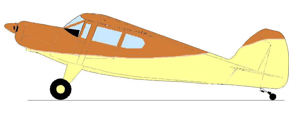

Your paint scheme looks great! Actually, I "borrowed" the scheme from the HondaJet prototype.
I must admit that I am not an avionics expert and would prefer to differ your question to the many more knowledgeable folks on this list, however, aside from the minimum requirements depicted in the FARs, I would consider something like this:
[img]cid:892331803(at)19102007-0492[/img]
  • Dynon D100 - EFIS - Bright Screen
    • Includes Backup Battery, Mounting Tray, Remote Mount Compass, USB to Serial Port Cable & Factory Harness
  • Dynon D120 - EMS - Bright Screen
    • Includes 4 Cylinder Engine Probe Kit
  • Garmin GPSMAP 396
  • AirGizmo Panel Dock
  • Garmin SL40 COM
  • Garmin GTX327 Transponder*
  • PS Engineering PM3000 Intercom
  • UMA 2 1/4" Airspeed Indicator
  • UMA 2 1/4" 20,000ft Atimeter

Enjoyed your site, and wanted to to know I am adapting your paint scheme to a Bearhawk (file attached- dark color is a bright,deep orange over a complimentary yellow shade - used for visibility in the bush). I like the simplicity and I think it lends itself well to the Bearhawk lines.
Using your ideas for instrumentation, what are your thoughts on instrumentation for a VFR airplane, that might occasionally, file special VFR to get out of a low ceiling situation flying into clear air?
M. Haught

PostPosted: Fri Oct 19, 2007 9:07 am    Post subject: VFR Preferred Instrumentation Reply with quote
Money, money, money...must be funny in a rich mans world.
Gee this an IFR panel minus a nice GNS 430 and the needles....way overkill, even for your supposed "Special" VFR departures (I say supposed because there is a fine line between special VFR and IFR...which will get you killed in short order)
Lets see you a gyro setup in the D100 which is totally not required and steam guage backups.
Your very best and most reliable attitude indicator is "looking out the window"...Thats what VFR flying is all about...On top of that this panel now has redundant ASI's and altimeters.
Its very nice but you will never use most of it VFR.
If you really must have that "special" capability your still better off with a wing levelling autopilot that will keep you sunny side up without having to have the skills of an instrument pilot...I.e engage the A/P onthe ground and fly stright out up and thru.
Frank

PostPosted: Fri Oct 19, 2007 10:42 am    Post subject: VFR Preferred Instrumentation Reply with quote
Frank,
I agree with you up to a point... The panel shown is an actual panel offered by Chief Aircraft and sells for $11,450.00!
http://www.chiefaircraft.com/airsec/Avionics/Avionics.html
You can actually do even better through John Stark. He had asked what "I" would suggest for a VFR panel with some IFR capabilities. The addition of an autopilot is for workload reduction or as a primary backup in the event of an in-flight emergency.
I suppose any discussion on panel instrumentation should really be prefaced with the intended price range...i.e.,
VFR panel under $5000.00
VFR/IFR panel under $10,000.00
IFR panel under $20,000.00
I personally know many pilots who spend $100,000+ for a spam can with 20 year old avionics only to spend another $20,000 to upgrade the panel. To each his own.

11K really?...WoW!..I paid 9k (with a 430 and needles) for a full IFR panel in the RV7.
I think the discussion started with our VFR friend wondering what he needed in the panel...The approach I took is "you better be able to see out the window"...And if you can then an AI is redundant...But an A/P is a useful device and can be used to get your tail on the ground (together with a resolution to get an IFR ticket) in the event of the WX emergency.
At least thats how I ended up with my IFR ticket....Smile
Frank
