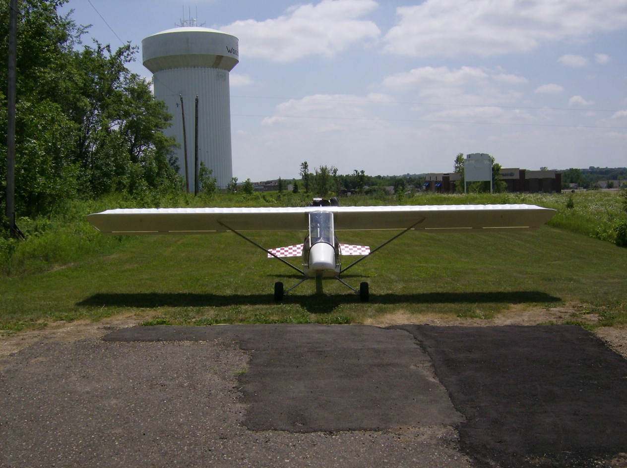

planecrazzzy
PostPosted: Sun Oct 14, 2007 4:02 am    Post subject: Re: Antenna location Reply with quote
I put my antenna on my Wing-Gap seal.... ( it's aluminum )
I also have my ELT antenna on it....
My transponder antenna is sticking out the bottom where the passenger sits.....but that one needed a grounding plane , I slipped it between the tubing and fabric....
I got rid of my rubber ducky antenna ,Bought the straight one from ACS
"I" sure wouldn't go putting holes in my tail boom ( but that's me )
I was told the antenna should also be "straight" up & down....
( I was going to put a Bent one on the belly )
Gotta Fly...
Mike & "Jaz" - Building a Buttercup
http://groups.yahoo.com/group/Buttercup-STOL/
Old rubber ducky antenna , suction cupped on the left side, hanging down,under plane...
