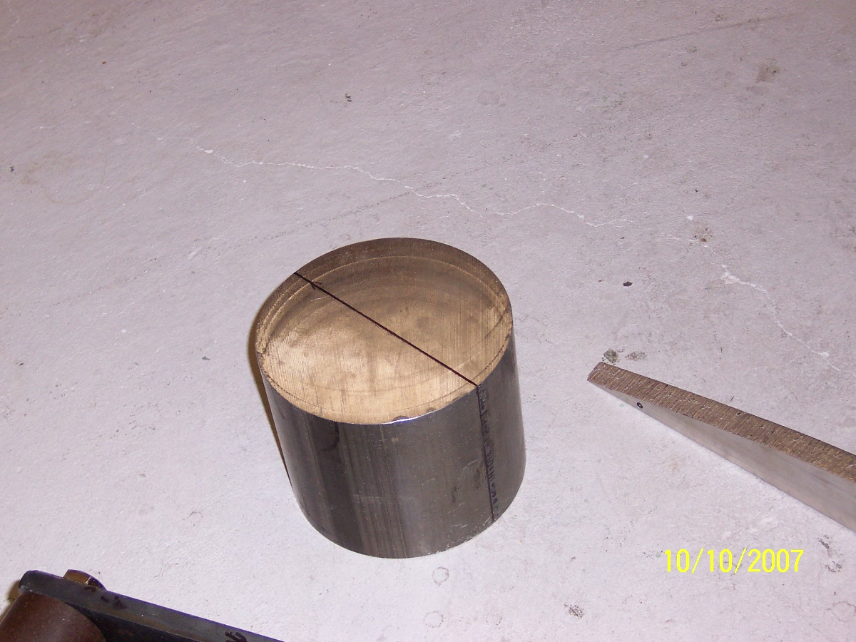

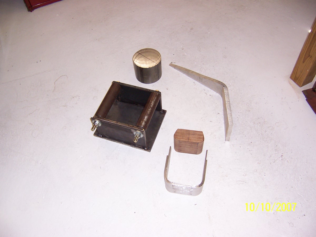

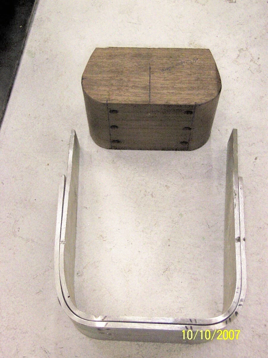

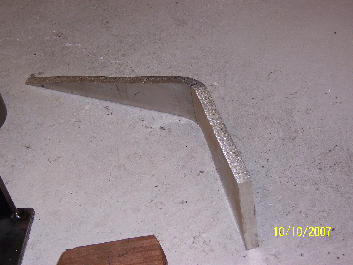

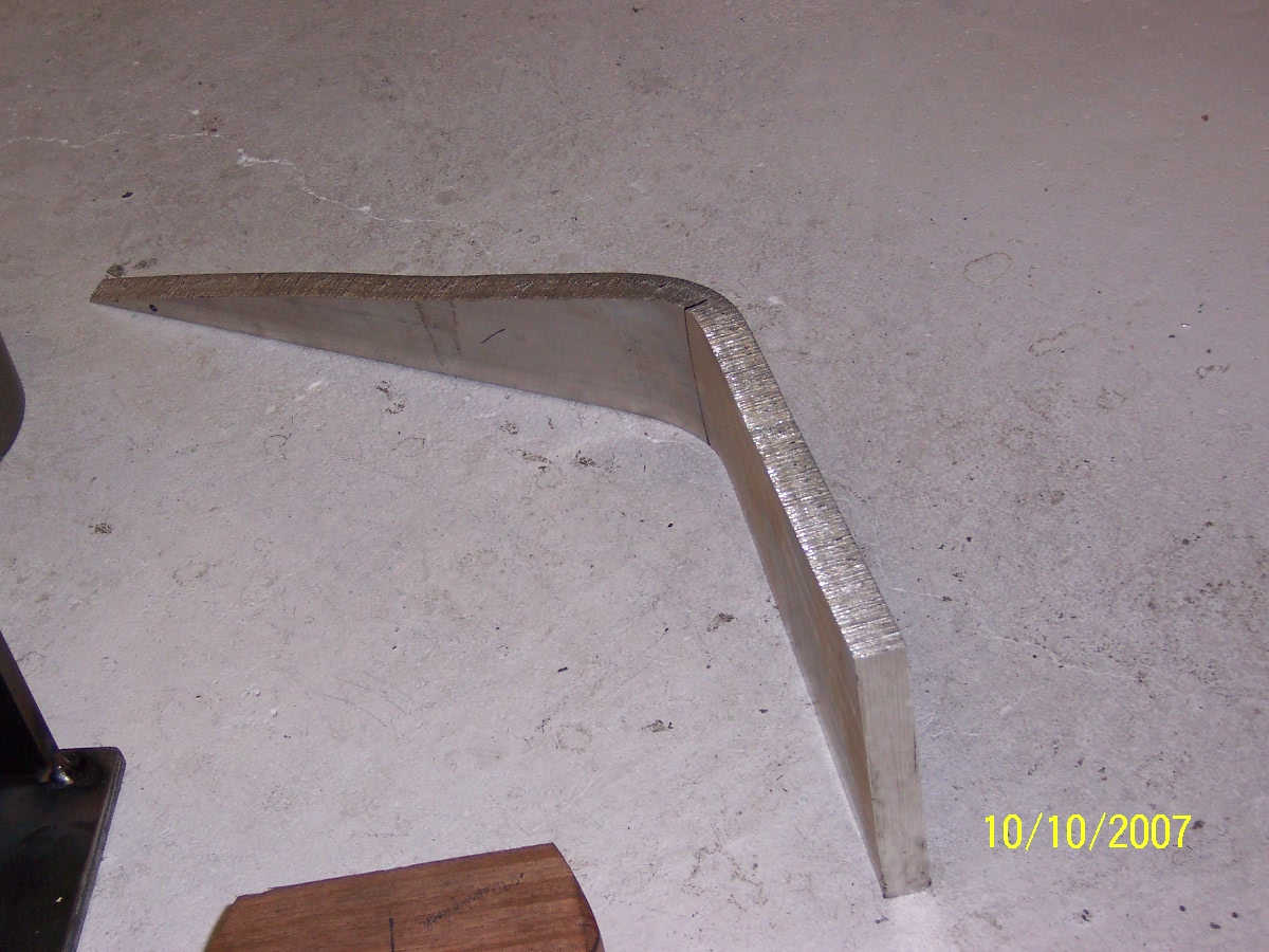

I'll get a write up and pics of the jig I'm using and get it on the fileshare thing for this group. Can't get it done right away, so give me a few days.

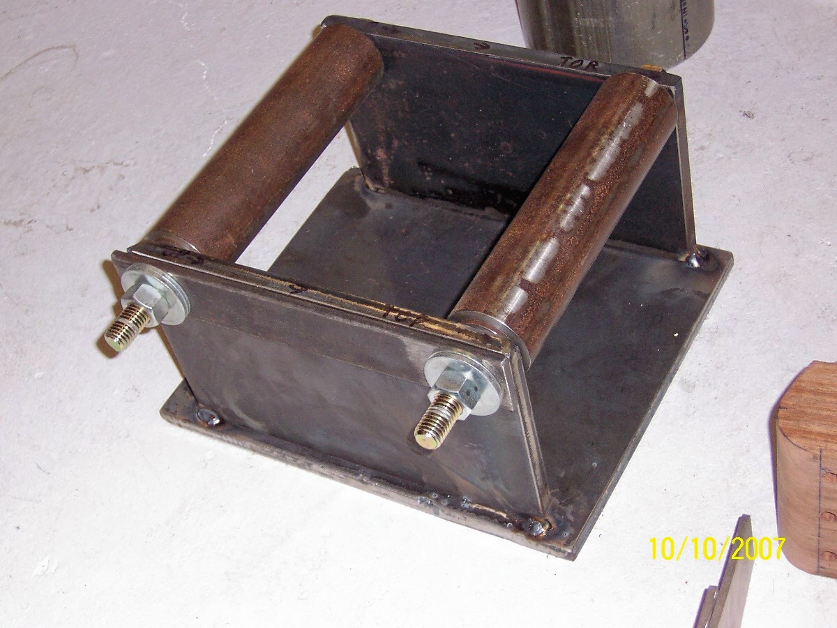

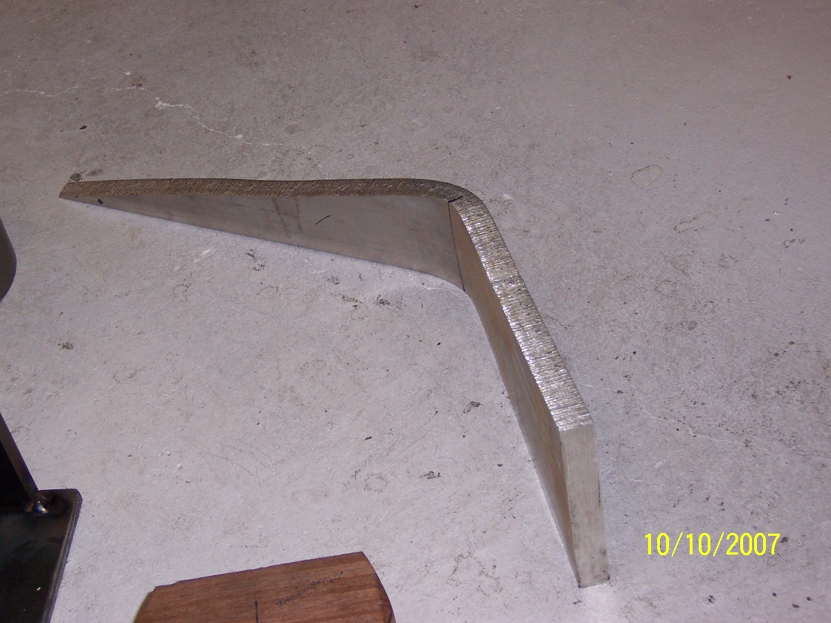

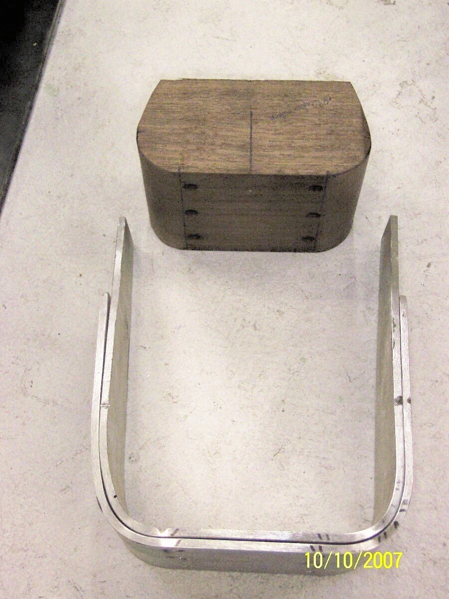

I've sent a write up and pictures to the matronics photoshare thingy. I guess you have to wait awhile for it to get to the fileshare/photoshare
facility. I've also sent it to Mark up at the ch601.org web site. I'll also attach all of it to this note. If you can't find it, send me a note and I'll e-mail you what I have.

Your write-up and pics are exactly what I was looking for. Very ingenious. Thanks for posting them here, and at the 601 site. Posts like yours are one of the reasons I still stay on this list. Thanks again for willingly sharing your set-up.
