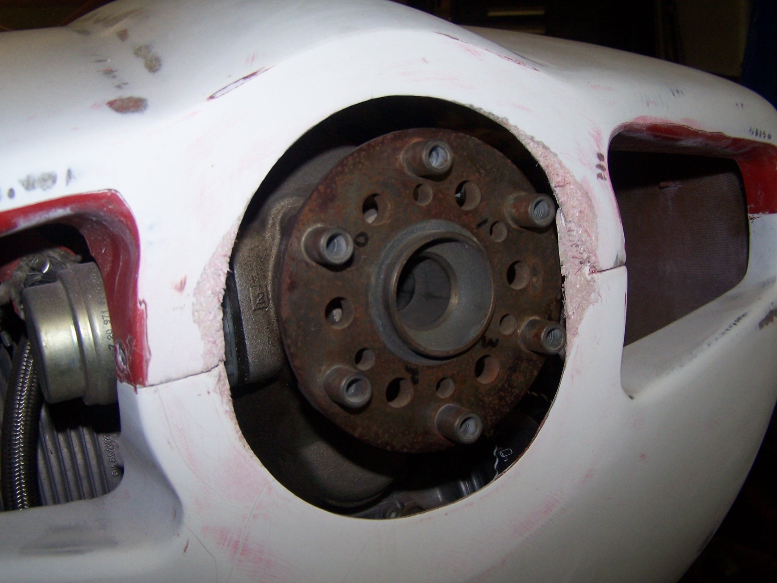

Thank you for your replies on the prop, that end of my project has been stalled looking for a prop, I purchased a GSC from another 912ul Kitfox upgrade but the hub did not fit my engine. I have attached a pic of my engine hub, bolt circle approx 4", bolt holes are for 5/16 bolts, bolt hole bosses are .510 OD and center boss 1.850 OD. Can anyone tell me what I need to fit this??

Hi Lloyd, What year is the engine? Rotax changed the bolt pattern after 1995 I believe.
