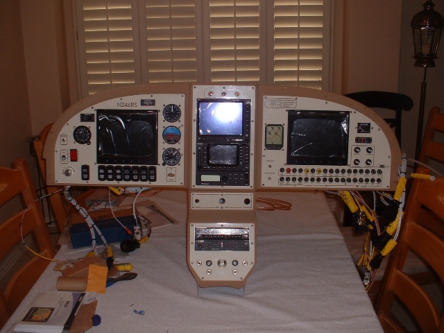

PostPosted: Mon Oct 08, 2007 2:18 pm    Post subject: Panel choices Reply with quote
Rick got any pictures?

PostPosted: Mon Oct 08, 2007 4:02 pm    Post subject: Panel choices Reply with quote
Heres one prior to install, installed ones were too blurry, need a better camera, can't afford one now Wink
