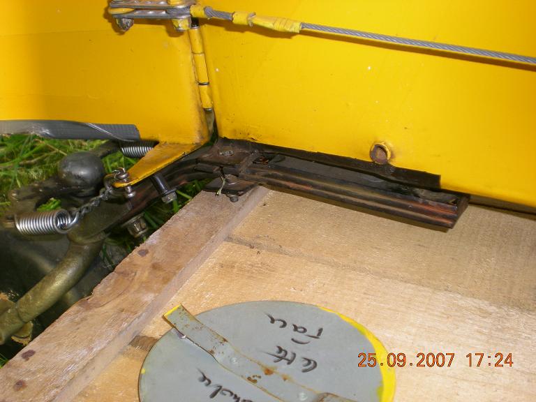

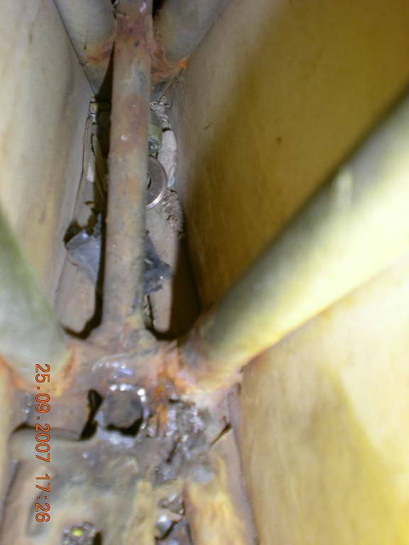

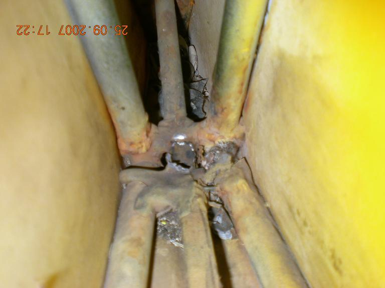

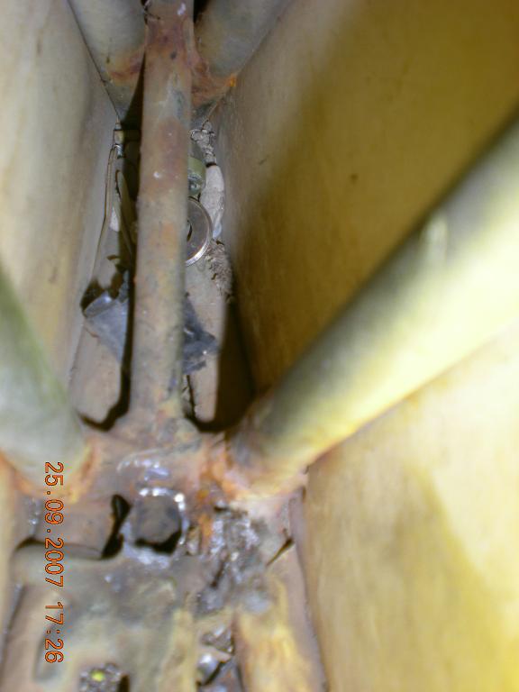

When I made my landing sunday, I noticed I could not steer my Kitfox either left or right and was unable to vacate the runway.
So, I stopped the engine, looked behind and saw the front bolt of the tailwheelspring had broken. Of course, the rudder rested on the tailwheel, causing some very little damage there.
I was horrified when I made a closer inspection with my camera.
The picture showed that not only the bolt was broken but a piece of the tubing was also broken off.
I have no idea how this tube was exactly, so can anybody send me some good clear pictures of this tail section (before covering) so that I can see how the fuselage should be normally ?
Many thanks in advance.

PostPosted: Tue Sep 25, 2007 4:48 pm    Post subject: Re: Tailwheel bolt went off.... and the rest Reply with quote
looks like it has been repaired before?
Rusty too ?
whats up with that ?
Does not look too healthy .

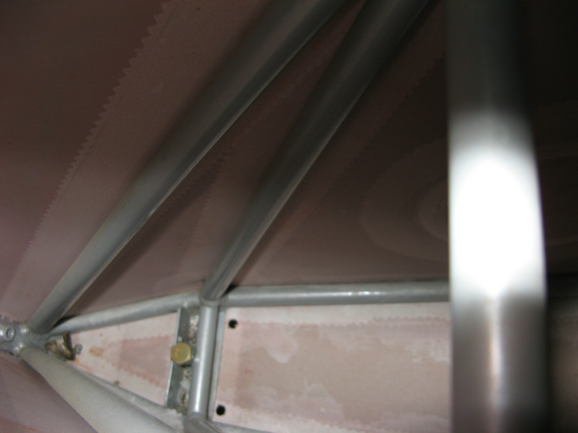

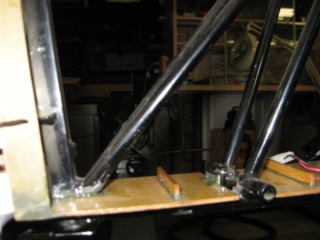

Michel, here is a picture of a Classic 4 tail wheel bolt tubing. Note the drain holes in the fabric to let the rain water out.

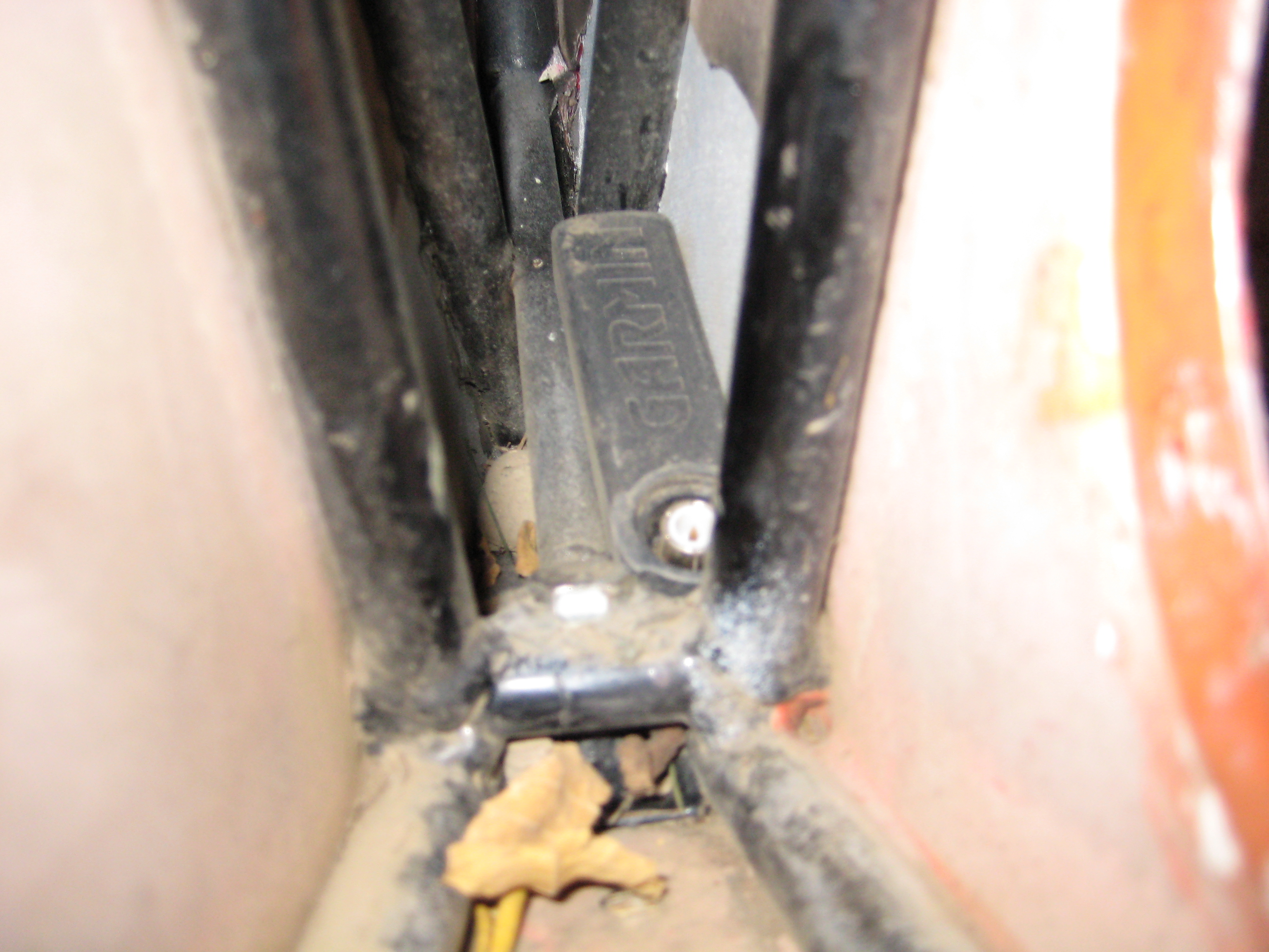

Michel ,
I took some pics for you of my tubes inside the inspection hole.
hope this helps you.

jezim(at)pro-ns.net
PostPosted: Thu Sep 27, 2007 11:19 am    Post subject: Tailwheel bolt went off.... and the rest Reply with quote
 Filesize:  38.17 KB
 Viewed:  882 Time(s)
jezim(at)pro-ns.net

PostPosted: Thu Sep 27, 2007 1:10 pm    Post subject: Re: Tailwheel bolt went off.... and the rest Reply with quote
I asked the previous owner.
The aircraft has been previously repaired after a former bolt rupture.
It looks like it hasn't been repaired very properly.
I'll see this weekend with a mecanic.

PostPosted: Fri Sep 28, 2007 2:39 am    Post subject: Re: Tailwheel bolt went off.... and the rest Reply with quote
Michel -
Sorry to hear that you need to repair your KF. It looks like the hole has taken a beating and I'm wondering if the bolt/nut was tight.
Find the remaining head or other portion of the bolt and show it to a metallurgist. He can tell very easily if the bolt was involved. For example, did th ebolt have a flaw, break in overload, had it cracked long before the failure, or did it break only after numerous cycles of use (as if loose)?
Bob
