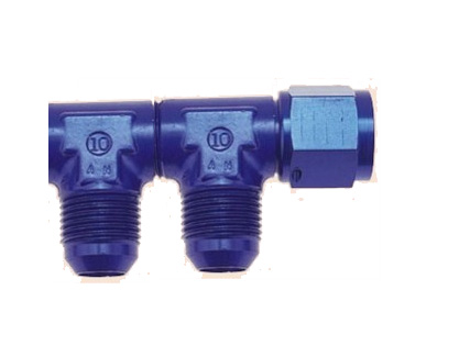

PostPosted: Tue Sep 25, 2007 6:34 pm    Post subject: Special fitting required Reply with quote
If you don't find that then maybe a manifold would work.
MANIFOLD AL FITTING FAB-1-0-6
http://www.aircraftspruce.com/catalog/hapages/anfittings/manifoldfitting.jpg
http://www.aircraftspruce.com/catalog/hapages/alummanifoldfit.php
William
