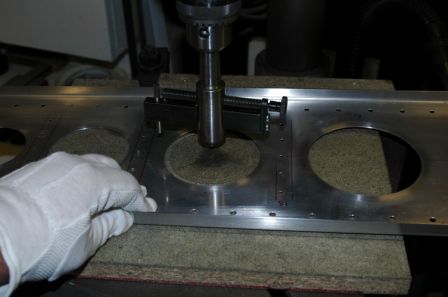

Photo show my cutter (the disk is removed) ...Slow speed and a back stop
for the rib / spar

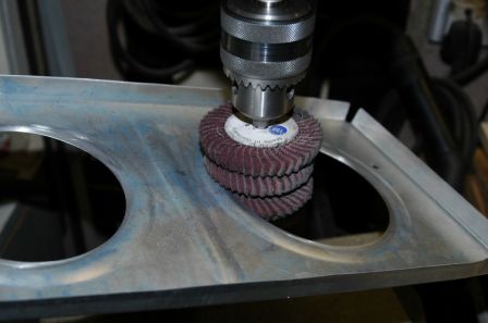

PostPosted: Tue Sep 25, 2007 1:14 pm    Post subject: RV-List Digest: 9 Msgs - 09/24/07 Fly cutters Reply with quote
A fast way to clean up the holes after cutting out the disk ...
Jan
