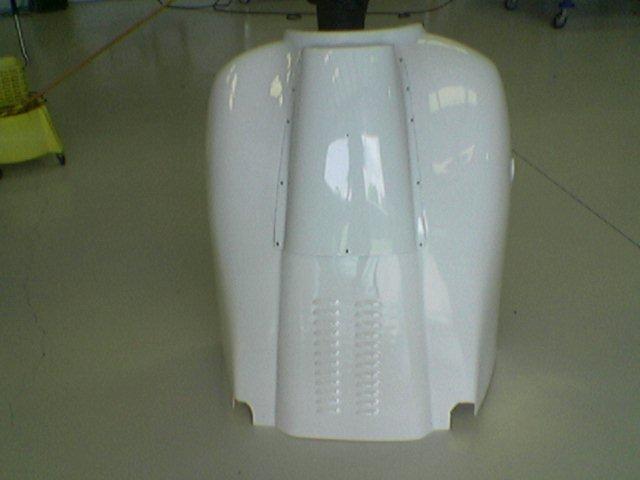

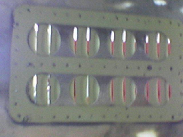

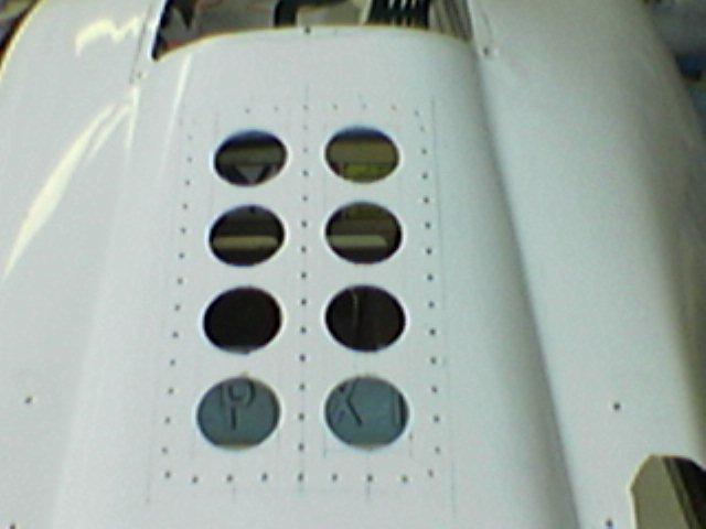

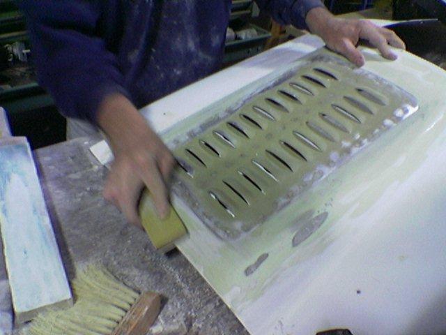

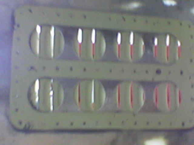

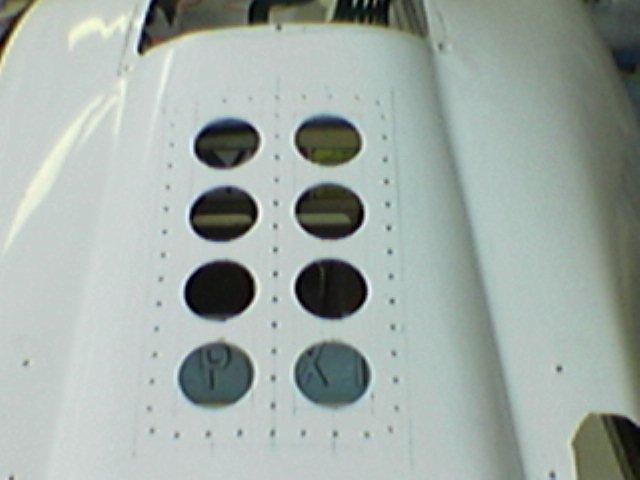

I have a stock IO540 and fought CHTs forever, tweaked baffling mesed with timing. Got to where all was ok in cruise but always on climbout I quickly blew through 400Deg F everytime.
Finally put louvers in and have had no problems since.
I think your friend with the louvers probably has an additional issue.

I'd like details re: the louvers. I fly 116 very gingerly in the summer, have a ball with it in the winter. It has cold air induction, tuned exhaust and a plenum, but still seem to run hot.
