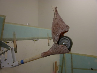

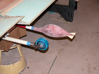

The exposed outrigger wheel is a source of drag which the speed kit
fairing doesn't address. Here are some pixs of a fully enclosed
outrigger which has a spring loaded afterbody which hinges up when
flaps are deployed; airstream on mini-tailplane locks it back down when
flaps are raised...this is a prototype not yet tested in flight...(hey,
we're building experimental aircraft, are we not?)
