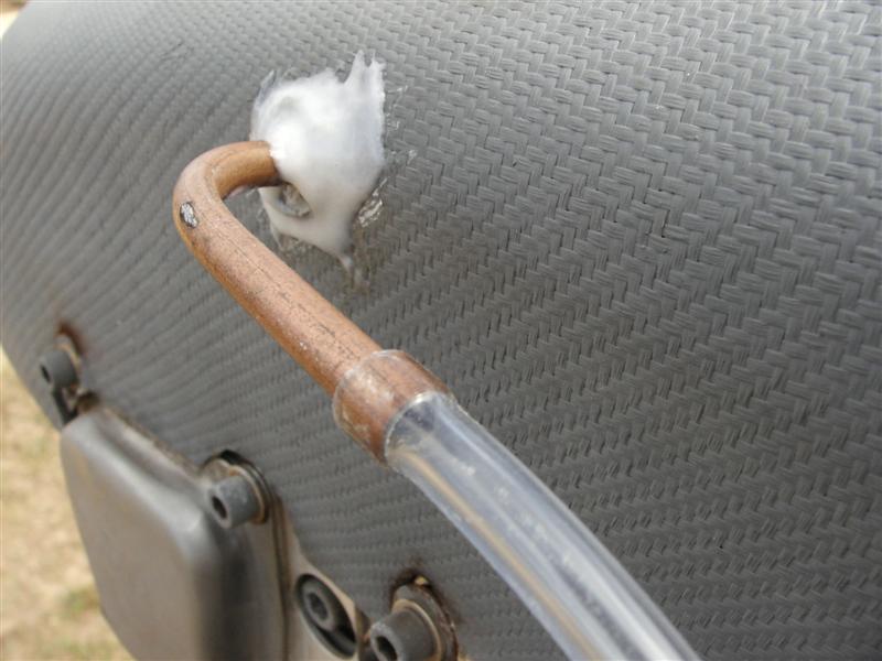

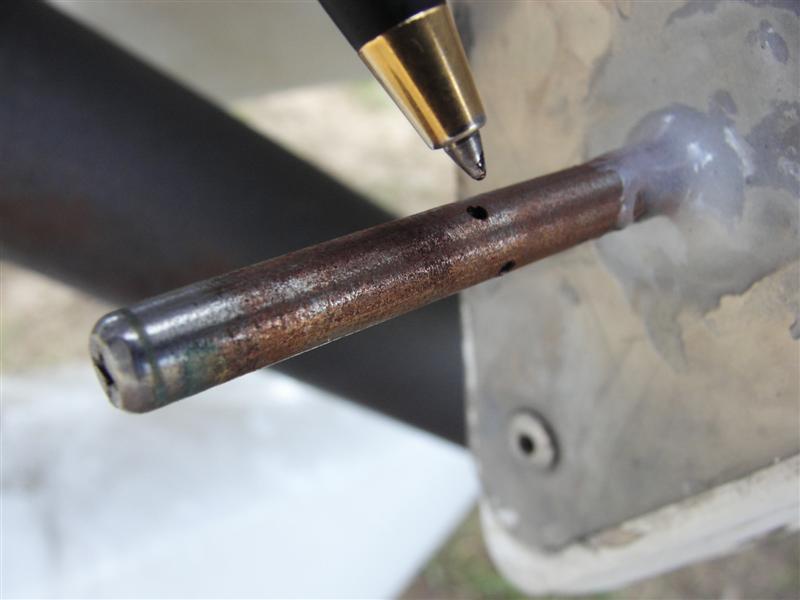

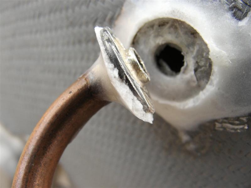

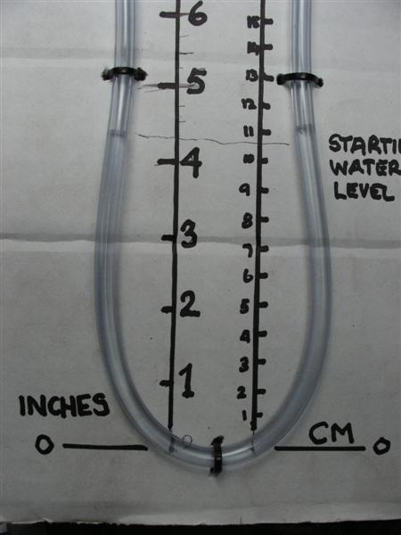

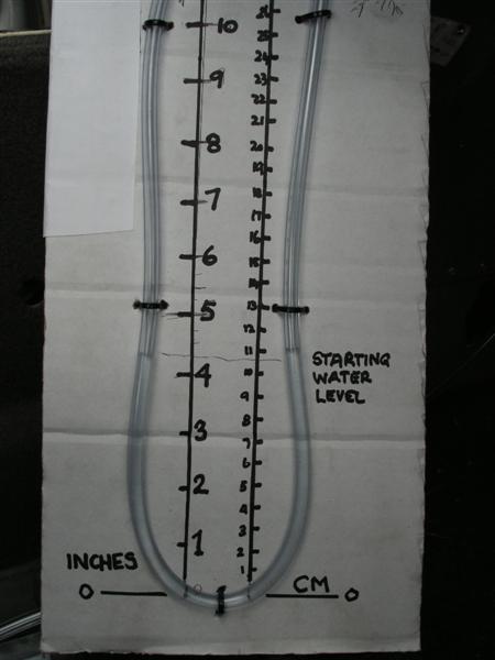

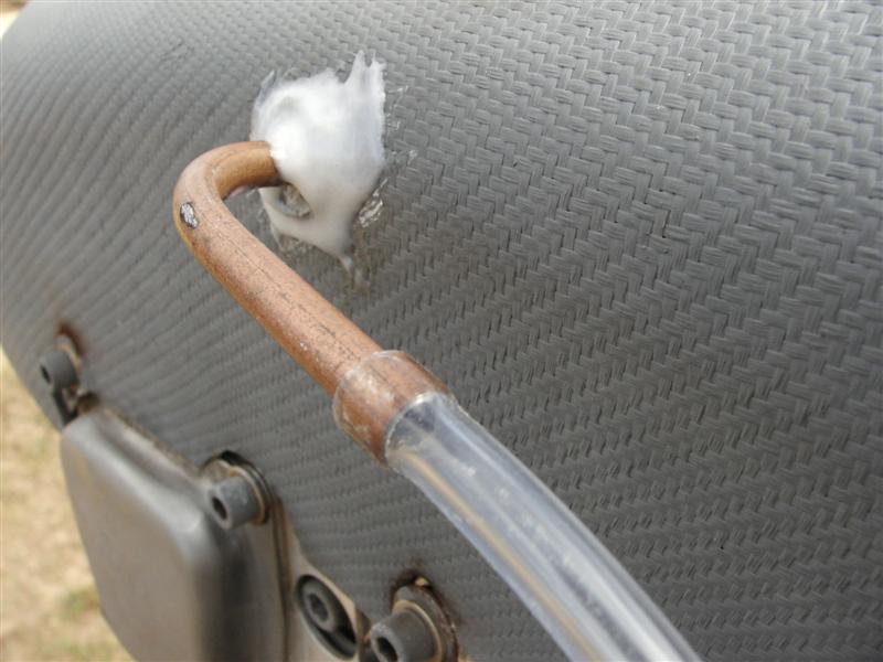

The following information was received by Dealers from Jabiru, and is posted in advance of being incorporated into manuals and warranty policy:
To avoid overheating problems of the Jabiru engines in non Jabiru installations, it is vitally important that all installations provide a greater that 6 inch of water, air pressure differential to provide enough cooling for the Jabiru engine. Attached is a diagram of the tube placements to measure this and photos. We are in the process of having this included in the engine manual as a condition of warranty.
Attached is a diagram and photos that demonstrate how to perform this test.

1. The latest test has different reference points than before, when the pressure was compared with ambient and at an airspeed of only 1.3 Vs.
2. The higher pressure differential reflects both pressure and suction, i.e. inside the cooling duct is compared to a point adjacent to the cowling outlet.
3. The 6" differential will be obtained at normal cruise speeds, which is easier to monitor in the air rather than (in my view) trying to maintain a speed of 1.3Vs and looking at the manometer.
