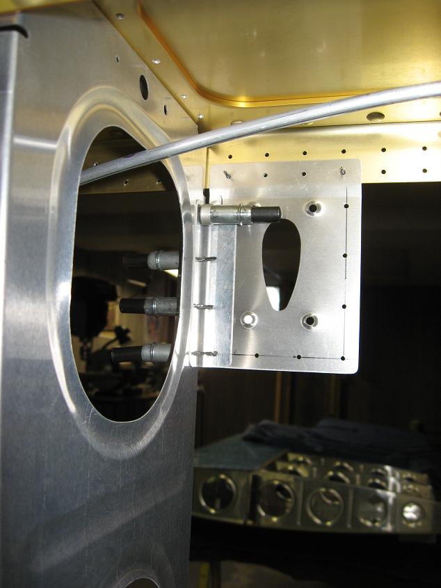

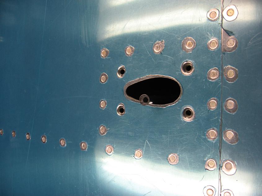

Like many builders, I moved the pitot installation outboard an extra bay to help avoid potential conflict with tie down ropes. The photos should give you a general idea of a typical Gretz installation regardless of where you decide to locate it.

Carl

Rick,
Great pictures, thx.
All, the Gretz came in today, and the instructions are good, I will move it one bay out and RTFM. Thank you all for your help. Carl
