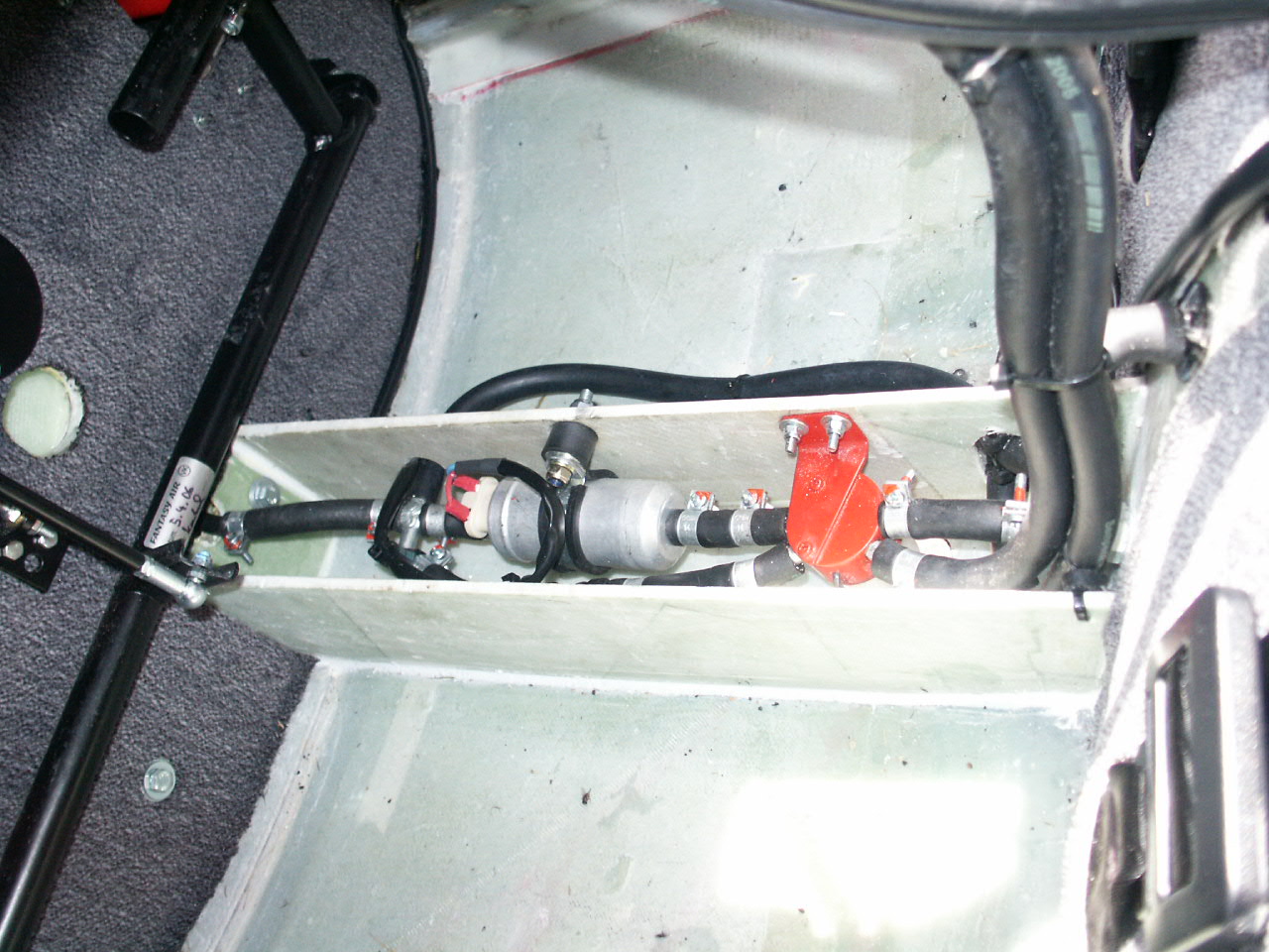

I have not had any problems with the battery after using it for 30 mins
I enclose a photo of the plumbing in the pump area
Paul

Paul: Thanks for the photo; it looks just like mine. I assume you also keep
the choke CLOSED during the pumping.
