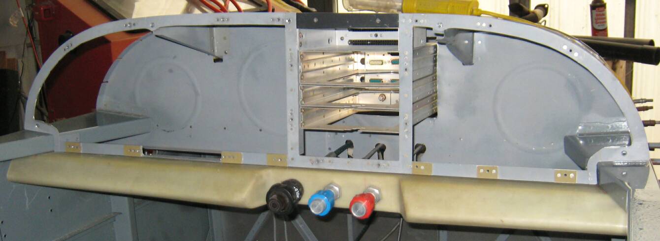

I'm considering covering the fiberglass switch panel I made with the same leather I bought for the seats/sidewalls. The trick is the inset for the controls so it needs to be molded somehow. Picture attached if it gets through. I've never done anything like that before but that's part of the fun isn't it? (gulp!) It sounds like wet-molding may work but what I've turned up is very short on details and focuses on holsters and sheaths with stitching and rivets, not a covering to be glued on. Has anyone done something similar and can offer some pointers or source for more info? I'm hoping it turns out to be simple but I'd prefer not wasting a lot of leather to find out otherwise. Thanks

Greg, If a good heat gun and some stretching in the area of the recess in the center aren't enough to get the material to lay flat you could cut a horizontal relief in the material in the area of the cables and cover the cut with a separate leather wrapped overlay of thin aluminum. Matching vinyl material if available would be more pliable then leather. If you make pattern out of vinyl a local upholstery shop should be able to sew the material for a custom look but you have to be careful where you put the seam to keep it out of the way.

Thanks Larry. Are you talking about using a heat gun on dry or wet leather? I hadn't seen that. Does it work like vinyl? I've thought about sewn seams (I've got a machine for upholstery - still learning that too) but am concerned about the multiple thicknesses. Since it's going to be glued down I thought about butt-joint seams but wonder if they will lift or swell/shrink over time. So many questions... Thoughts anyone?
