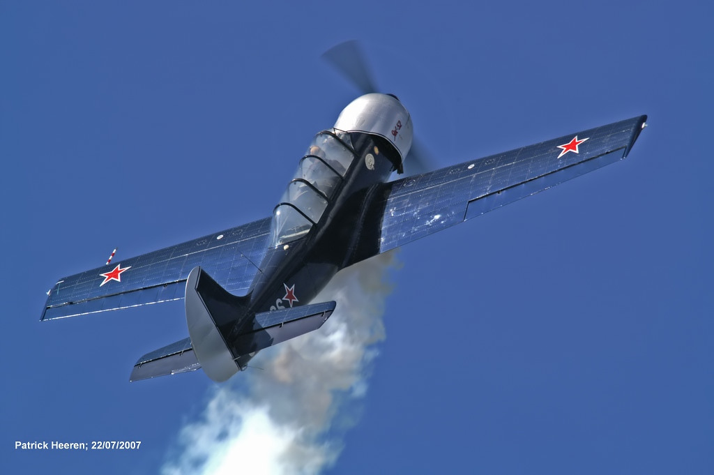

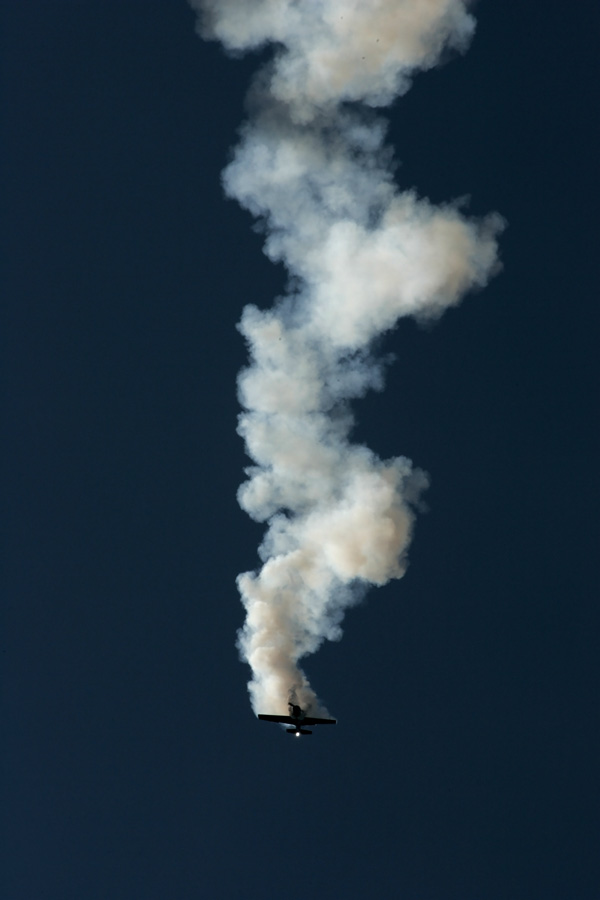

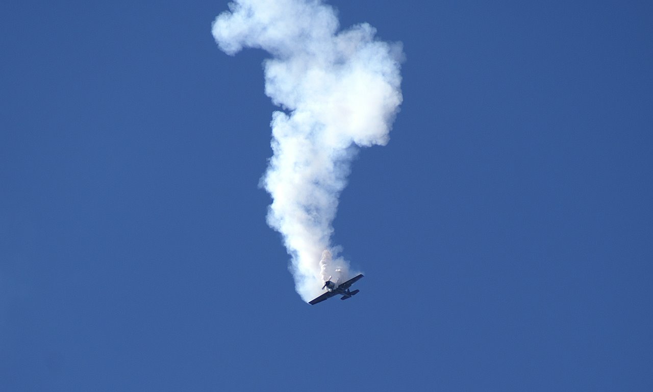

PostPosted: Thu Aug 09, 2007 11:54 pm    Post subject: Yak 55 smoke system Reply with quote

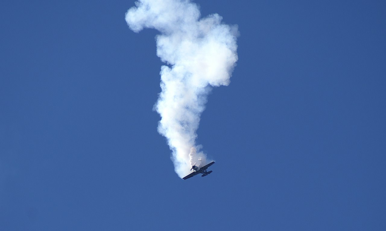

Hello Herb,
"Janie", our Yak 52 (registered G-CBSS in the UK) has smoke system.
Installed by Yak UK behind the back seat. About 20 liters.
With a reversible pump and a refill point on her belly !!
Leaks a little bit but other than that ... no problem.
And Yes, we do Flat spins and Lomcovaks ... with smoke. Wink)
You can contact Yak UK or Termikas for more info.
See attached pictures.

Very nice flat spins......and I love the cockpit full of smoke too Smile
There I was thinking it only happened to our CJ6 Wink
