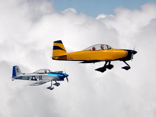

I painted my RV-8A using top end PPG Concept base/clear coat. Total cost for material was $2500. If you keep your scheme very basic (white with a stripe) and do as much labor yourself as possible, I’d guess you would be in the $8000 range for a shop to do it. The high end is whatever your pocket book can handle.
Painting it yourself is not all that hard if you use forgiving paint products like PPG Concept. My plane is the yellow one in the attached photo. The other RV-8 was also painted by the builder.
Carl Froehlich
