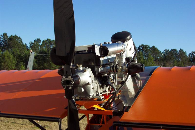

Oops! I should have posted a photo of the area I'm talking about. In the attached photo, I'm thinking of cutting the gap seal cross wise about where the rear most part of the BRS mount is located, and not use the part aft of that area, leaving it open.

My cover ends at the front of the engine. I have no problems. Maybe it would lower my stall speed a little if it came back farther but I'm happy with it.

That's just what I did to my gap seal on my Original firestar it didn't change the flying characteristics at all

Thanks, guys. That is what I figured. Mine will be shortened soon.

The low pressure air on the top of the wing will be trying to draw the lower wing side high pressure air up to the top side....if you prevent that by either a top or bottom seal, I dont think the overall lift of the wing will be altered much.
If you allow an air path from the underside to the top of the wing at the root I imagine you will get slightly reduced wing lift plus vortices and turbulence right in front of your prop.
I know of at least one designed ultralight that advised its owners to NEVER fly without the wing gap in place...so perhaps there IS a significant effect involved if you modify yours.
Have no idea what that will do to the control feel on the tail or the turbulence at the prop, but let us know if it has any noticable effect at all.....your going to be a Test Pilot!

I don't know about others, but the lower camber of the wing over the cage is wide open and air enters over the full enclosure windshield, below the leading edge of the gap seal and escapes wherever it can, which is currently below the wings just above the cage, if that is a low pressure area. If anything, I would think that opening up the top aft half of the wing there, will allow better airflow through that area.

I fly my firestar without a gap seal on real hot days it really dont make much difference  on how it flys

Well there we have it, someone who has tried it says it makes no difference.....thats a good thing!
I expect the extra cooling airflow around the engine can't hurt anything either.
Nothing better than real world testing to give confidence to forge ahead.
