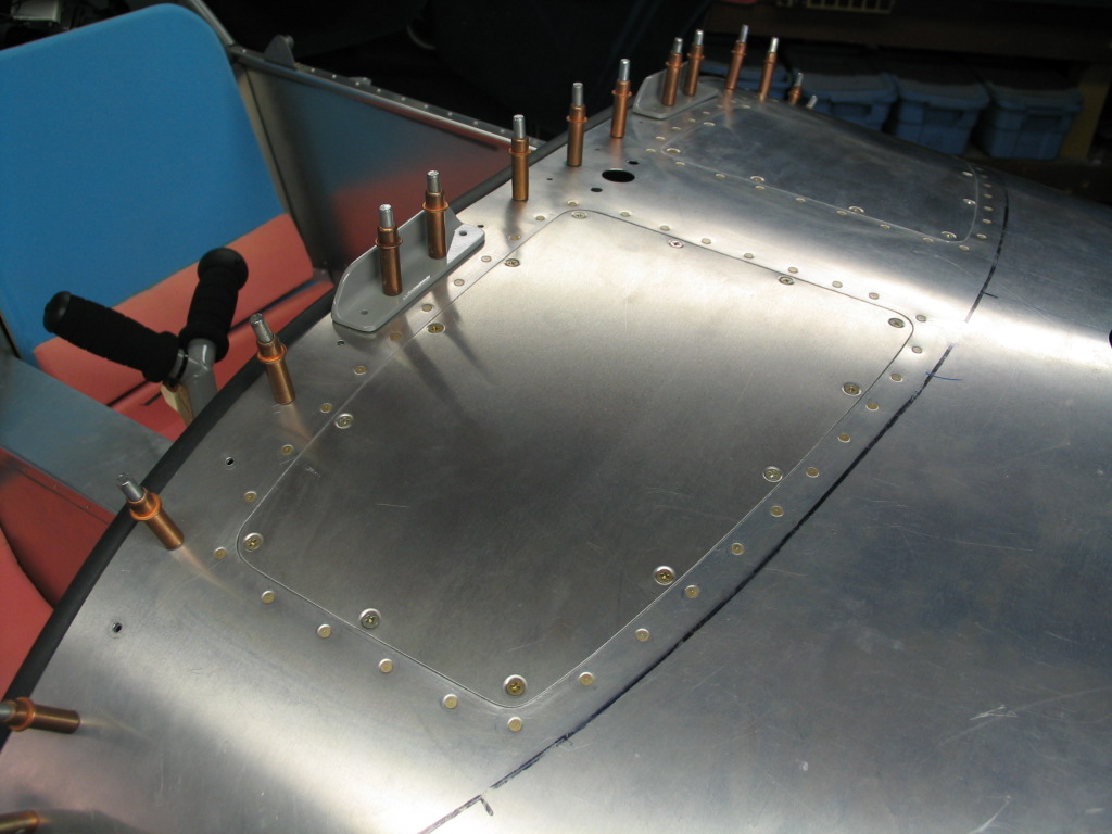

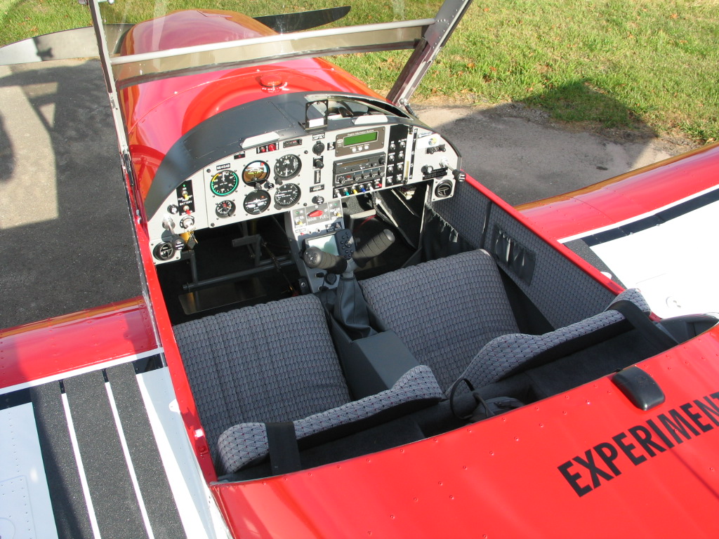

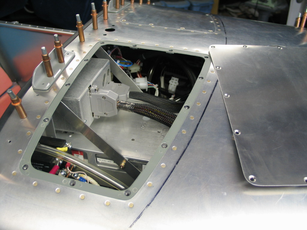

PostPosted: Sat Jul 14, 2007 3:45 pm    Post subject: panel access Reply with quote
Skip,
Here are a few pics of what I did.
Al from Oshkosh - 601 HDS
 Filesize:  172.29 KB
 Viewed:  364 Time(s)
 Filesize:  196.57 KB
 Viewed:  420 Time(s)
 Filesize:  312.98 KB
 Viewed:  368 Time(s)
