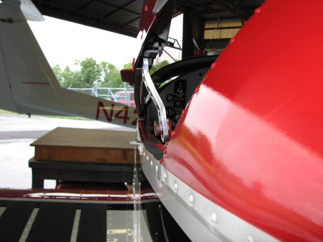

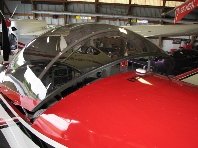

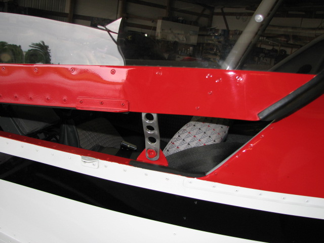

A few days ago someone asked about holding the canope open when they taxi. Here are a few pics of the link I made. It holds it open and will not let it flip up in a tail wind. If there is any interest in them I might make a limited number. It is for the forward tilting canope.

PostPosted: Thu Jul 12, 2007 6:48 pm    Post subject: Canope Link Reply with quote
Alan, I can't make it out from the pictures and I've lost your original e-mail. What does the link connect to on the latch on the canopy?

PostPosted: Fri Jul 13, 2007 3:17 am    Post subject: Canope Link Reply with quote
Craig,
I turn out a knob that looks like the one on the lower plate and it clips into the latch. I can send you a pic of the link when not in the latch if you would like.

craig(at)craigandjean.com
PostPosted: Fri Jul 13, 2007 7:21 am    Post subject: Canope Link Reply with quote
I understand now but a picture at some point would be nice. But as it requires a lathe it isn't something I can make. Add me to the list of folks interested in buying one.

PostPosted: Fri Jul 13, 2007 10:21 am    Post subject: Canope Link Reply with quote
Got that Alan. I meant more in the sense of pre-empting you than deriving you of income. Your offer to make the item for those who are timid of doing so for themselves is a generous one. Your charge would barely cover the materials I'm sure. I merely wanted to point out that there are alternatives available to those of us who only wish that we had a lathe. If I stepped on your toes, I apologize.
I like your idea very much and plan to use it.... thanks for the inspiration. I also picked up on the padlock hasp bracket outside the canopy. That is what I saw, isn't it? I lik ethat idea too. I envy your originality and your location.

agbeyer(at)sbcglobal.net
PostPosted: Fri Jul 13, 2007 6:05 pm    Post subject: Canope Link Reply with quote
I only use one on the left side. The only time I will not use it is if the field is very rough. I have used this link for over two years and it works good. My problem is that I work in engineering and always want to make everything better, so when I started to see some interest in these links I went to my hangar and measured things up to try and disign a new one. Dred, good job looking at the whole picture and not just the link--Yes that little tab on the bottom is for a small pad lock. There is one of those on both sides. I tried to come up with a simple way to slow someone down from opening the canope. If they wanted to get inside bad enough they could smack the canope with their fist.
