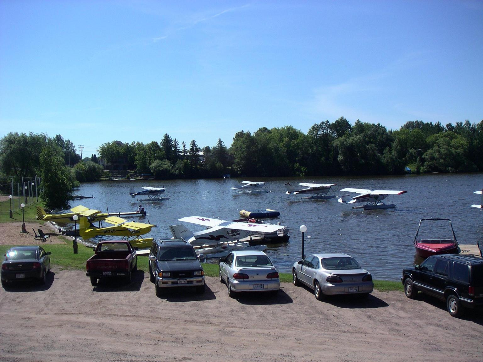

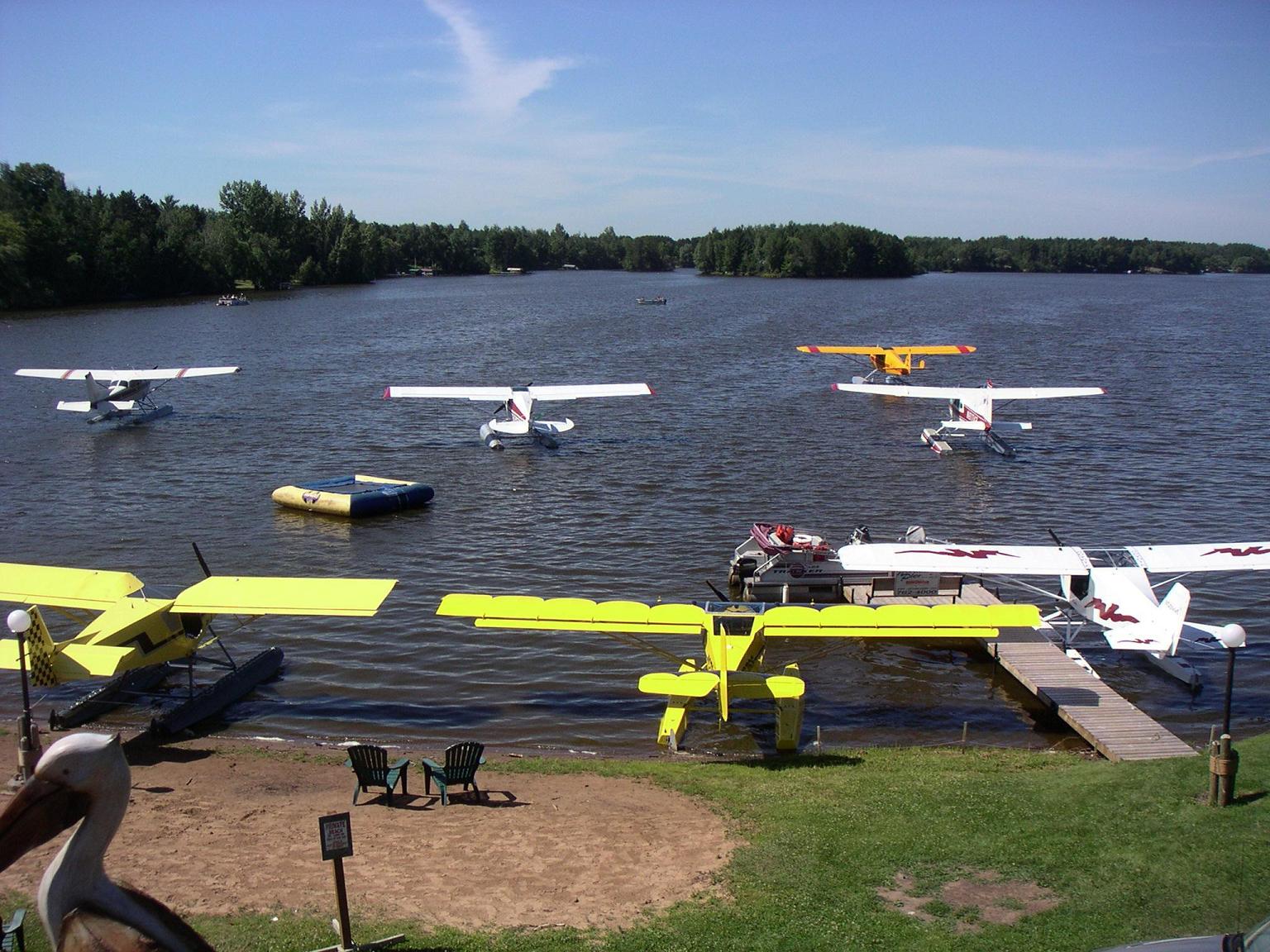

Attached are a few pictures of a small seaplane fly in that was held in
Phillips Wisconsin last weekend (we had 17 airplanes total if I counted
right - some aren't showing in these photos). The Kitfox, the Zenair, and
the Rans in the picture are all 912 powered, and can all fly 100 mph on
floats, burn half or less the fuel any of the other 100 mph floatplanes,
while still providing STOL performance and good load hauling ability.
Further testimony to the effectiveness of the 912's. They do the job
well...
