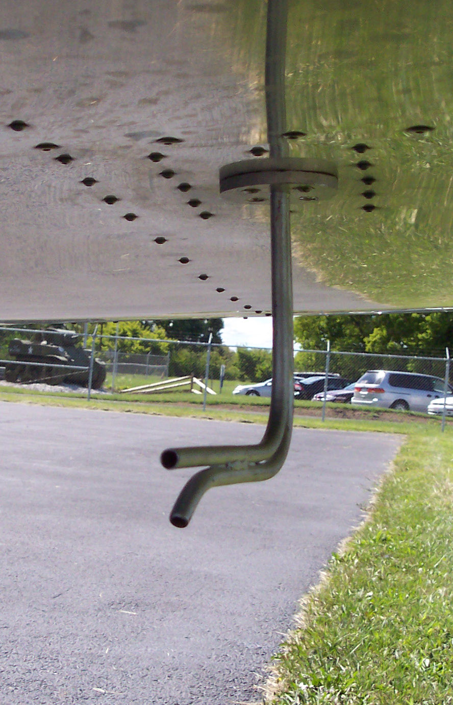

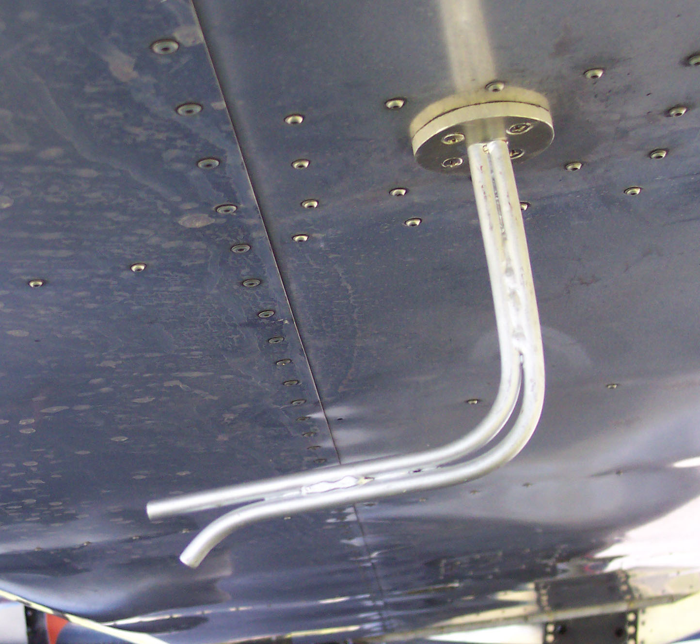

For all of you who have or are thinking of buying the Dynon and think
you would like to be able to use the angle of attack indicator it
doesn't have to cost another $200. I bought my Dynon for the attitude
display and everything else was gravy. It wasn't until after I was
flying with it I even realized that it have the AOA option. Being a
builder oh and cheap too, I though $200 was a lot to pay so I looked
into Dynon's and other AOA devices. Well anyway I made my own probe,
cost nothing time about an hour or so and I can report it works great.
Attached are a couple of pictures of the installation. The trick to ease
of fabrication is that I used copper tubing, easier to solder together.
The pitot tube is at a right angle to the support tube and the
additional tube is angled 45 degrees down. To hold it I made a slot in
the circular piece of 1/8 inch aluminum, I used my mill but it can be
done with a drill and careful file work.. Mine as a snug fit to which I
added epoxy. By the way don't start on how that copper is going to
corrode with the aluminum I keep my plane inside and dry and I haven't
seen any at other interfaces in the past year.
Tim Shankland

Gig Giacona
Posts: 1416
PostPosted: Tue Sep 18, 2007 7:13 am    Post subject: Re: AOA for your Dynon Reply with quote
I have a couple of questions.
1. Have you flown with it yet?
2. Where is it in relation to the standard 601 Pitot/Static probe?
3. It looks alot like the standard probe. DO you see any reason that the standard probe, that comes in the kit, couldn't be modified into you design?

tshankland(at)sbcglobal.n
PostPosted: Tue Sep 18, 2007 4:05 pm    Post subject: AOA for your Dynon Reply with quote
Gig,
To answer your questions
1. Yes I have flown with it, I did a series of stalls as indicated in
the Dynon instructions for calibrating the unit. I have also flown it
twice since and the indicator on the Dynon gives a steady reliable response.
2. It is the pitot tube. The Dynon used the pitot tube as one of the
references and the angled tube as the other. All this or any other AOA
is is a sum of the vector magnitudes of the air in each tube. It can be
shown mathematically, and I have, That with the two probes as shown
there is a linear relationship between the angle of attack and the their
pressure differential.
3. It is a duplicate of a standard probe, the only reason I used
copper is that it was easier to solder them together. You could use the
existing pitot and add the second probe you just have to fasten them
together. tie wraps?

Gig Giacona
Posts: 1416
PostPosted: Wed Sep 19, 2007 5:43 am    Post subject: Re: AOA for your Dynon Reply with quote
Let me ask this another way. On the pitot/static probe that Zenith ships the pitot is one of the tubes and the static is the other and they are connected together like yours but without the 45 degree bend on the other tube. Also the static probe end is blocked and there are a 2 or 3 small holes for the port.
I'm wondering if I could drill out the block in the end, fill the small holes and add the 45 degree angle and use it? It sounds like I could.
This would save a lot of problems, because I've already drilled for the Zenith mount. And would cost nothing because I've already paid for the zenith p/s probe.
PostPosted: Wed Sep 19, 2007 3:51 pm    Post subject: AOA for your Dynon Reply with quote
Gig,
Sounds like a plan, I have not seen the Zenith pitot, I scratch built my plane, but it sounds like it should work, the hardest part was pulling that extra tube through a finished wing.
Tim

PostPosted: Thu Sep 20, 2007 12:07 pm    Post subject: Re: AOA for your Dynon Reply with quote
I have the Zenith supplied pitot with static tube attached and I have run two tubes to the panel. I have decided to use the Zenith supplied tubes and test. That is, I will plumb the pitot to the correct connection and then connect the static to the two ports (in parallel) on the back of the Dynon. From what I read in the install manual, it wants to get static (not dynamic) air and that second tube from Zenith should provide that, without modification, to both ports. If not, where am I going wrong?
Gig Giacona
Posts: 1416
PostPosted: Thu Sep 20, 2007 2:00 pm    Post subject: Re: AOA for your Dynon Reply with quote
There are three ports on the back of the Dynon. Pitot, Static and AOA. The AOA is basically another pitot at another angle so the difference between the two is how the Dynon calcs the angle of attack. If you aren't using the AOA then it isn't a concern.

PostPosted: Fri Sep 21, 2007 4:12 pm    Post subject: Re: AOA for your Dynon Reply with quote
I guess the point is that I want to use the AOA on the Dynon without adding another pitot. Will not the static tube that Zenith provided work for the AOA on the Dynon? Reqading the Duynon test procedures, it just 'senses' the difference between dynamic and static in different settings so that it tells the on board computer what is going on in different flight configurations. I believe that the Zenith supplied static tube would fullfill this requirement. But I don't know for sure.
PostPosted: Fri Sep 21, 2007 6:32 pm    Post subject: AOA for your Dynon Reply with quote
Dave,
The way the AOA works is by doing a sum of the vector magnitudes of two
pitots. If there is no difference in the orientation of the probes you
cannot resolve that angle. The AOA does not use the static port that is
used for airspeed the AOA uses the differential between the two probes.
The AOA is not measuring the airspeed but the angle at which the air is
approaching the wing. This angle can be correlated with the stall of the
wing.
Tim Shankland
http://forums.matronics.com/viewtopic.php?p=135692#135692

PostPosted: Fri Sep 21, 2007 8:41 pm    Post subject: AOA for your Dynon Reply with quote
I don't have my Dynon unit yet, but I've been doing research and actually purchased the combo pitot/AOA probe from them. Don't confuse the static source and the AOA portion of the probe. They are completely different in size, shape and orientation.
As I understand it, the AOA computation is derived solely from inputs from the pitot tube (horizontal) and the AOA port tube (pointed approx. 45 degrees down), both located in the same combo probe. The pressure differential mirrors what is happening with the wing. Your static source is a different animal and can be achieved in several ways, but they are not related to AOA.

PostPosted: Sat Sep 22, 2007 5:27 am    Post subject: Re: AOA for your Dynon Reply with quote
Thanks. Now I get it. So I can modify the Zenith Static probe ( cut off the plug and bend down 45 degrees approximate and plug the small static ports drilled into the tube) to get the desired results. then I can add a static system similar to what Cessna has on the sides of the fuselage. Thanks for the input which should eliminate hours of aggravation.

PostPosted: Sat Sep 22, 2007 5:39 am    Post subject: AOA for your Dynon Reply with quote
In theory, that could work. You might want to check with Dynon for specs on the angle, distance between ports, etc.
