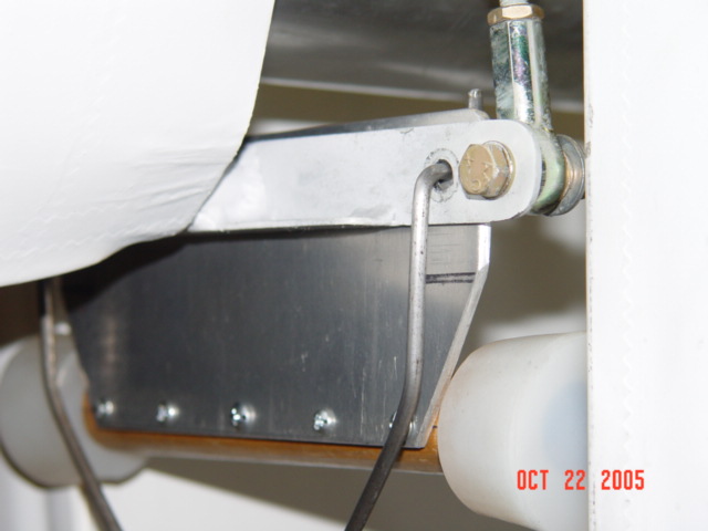

PostPosted: Wed Jun 27, 2007 12:27 pm    Post subject: Re: Aileron Forces Reply with quote

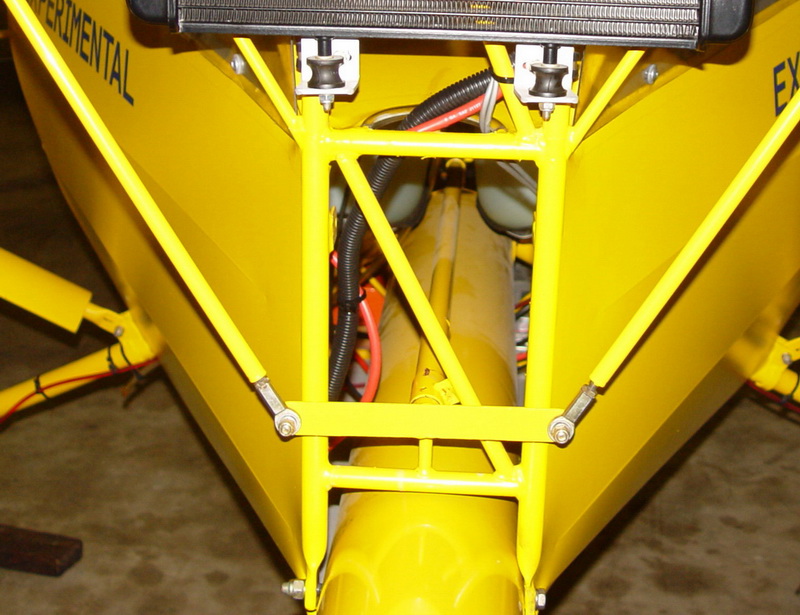

In the picture below ( attached )
You can see where I first put my aileron control rods....
it was suggested by "list members" to light the stick pressure.....
As you can see , I put it back in the "stock position"
The stick pressure isn't that bad , and I wanted more control for
those BIG gusts of wind....
Gotta Fly...
Mike & "Jaz" in MN / FSII - N381PM

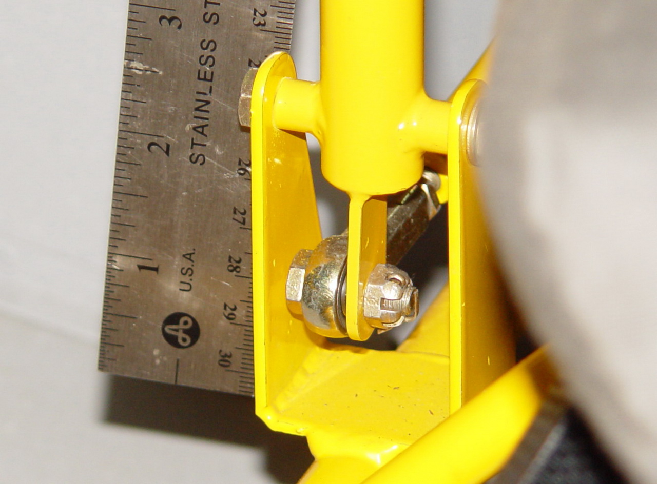

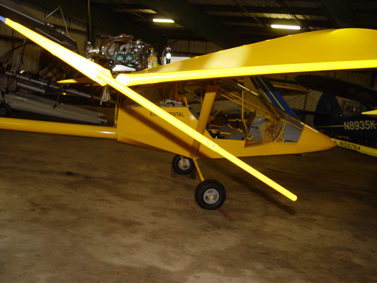

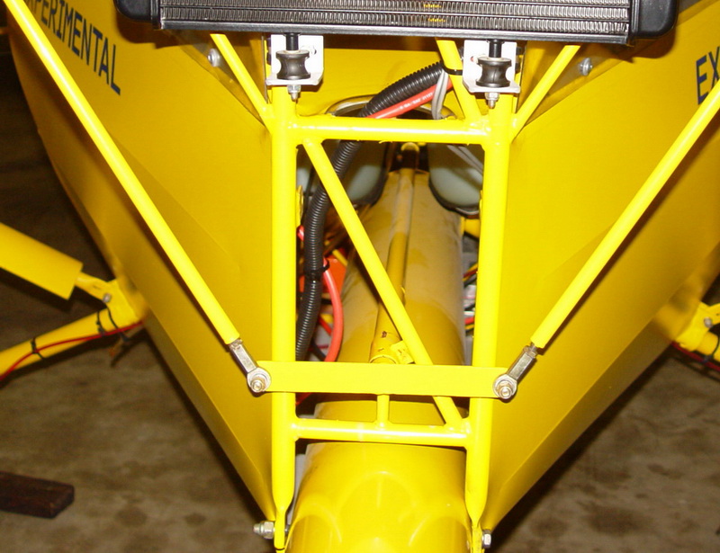

The aileron forces on the Kolb MK III are unreasonably high, and I have also been working to reduce my Aileron Forces... The Kolb is not an aerobatic airplane and does not need to roll fast, but there is no reason in the world that the roll should be hard and require a lot of effort.
First problem is in the linkage design, Kolbs have WAY TO MUCH travel built into the ailerons. My Kolb MK III Xtra had 40 degrees of up aileron which is as much or more than a highly aerobatic Extra 300. This is a design error by Kolb and needs to be fixed... I found even than in crosswinds etc, I never used anywhere near full stick. Secondly, anything past 25 or 30 degrees travel turns into drag, and does not give you more control. The easy way to fix this on a MK III is to shorten where the aileron rods attach at the rear of the fuselage as seen in the attached picture, but this brings other problems. First, it increases the angle of the aileron control rods to the point where they are pushing out as much as they are pushing the aileron up and down, so some of what you gained is also wasted. Secondly, it increases the aileron differential to an unreasonable amount. In other words, you get a lot of up, but very little down aileron the more you move these rods in.. Not good and I did not use this method to lighten my control forces. My solution was to drill a hole in the bottom of the stick, and shorten the aileron attach point to the stick, resulting in less throw and less force without all the disadvantages of the other methods. In the picture, I just drilled another hole above hole where the bolt that attaches to the stick, moving the attachment point up. This picture was before the modification, you can clearly see how much extra room there is to drill a higher hole.
Spades would be great, I plan on doing this when I have time. As far as stress, that is a matter of having the skill and judgement not to yank hard and overstress the ailerons at high speed, but that is the case with almost any airplane you fly. Big control inputs at high speeds are bad, from ultraights to airliners... Thats called pilot technique. I dont need rock hard control forces to keep me from doing something stupid. I would rather have an easy to fly airplane that does not tire me out quickly.
I would NOT shorten the ailerons, that reduces wing area and aileron area. There is no need to do this with other better, and easier options avialable.
