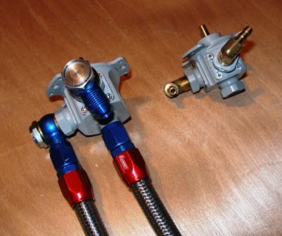

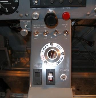

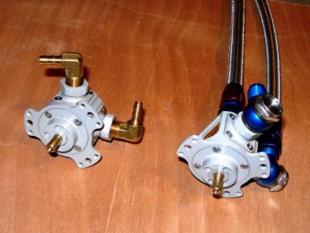

I had two problems with the ZAC-supplied fuel selector valve. 1) When I screwed the right angle hose barb fittings into the valve body, one of them could not be oriented correctly (by a long way). Not a product flaw, just the luck of the draw. 2) I painted myself into a corner by fabricating the center console panel, leaving the selector valve installation 'til last. As a result, I didn't have enough room for the selector valve and its fittings.
My solution was to buy a new selector valve from Andair with banjo fittings. I can make it fit, but I will have lower it about 5mm and rotate it 45 degrees. See photos.
Jay in Dallas

Not cheap, but you could use the Andair extension parts and retain the
original handle position and orientation using either valve. I'm extending
my Andair 5-Way valve down to the cokpit floor.
