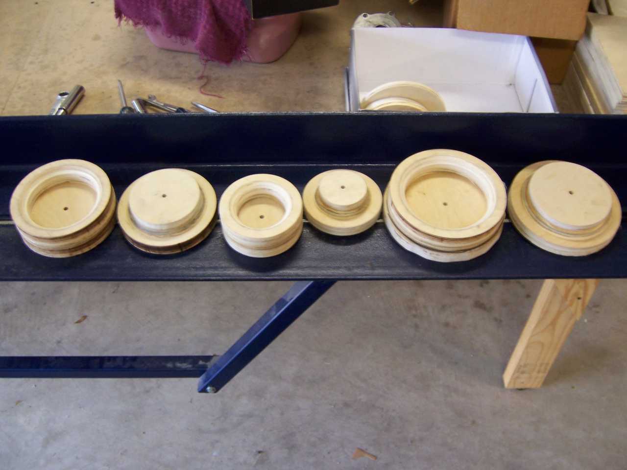

That thingy with the wheels does a crappy job on unflanged parts; I found that its actual use is to tweak curvature induced by the flanging process out of the part after the flange is formed. At this task, it works like a dream!
I screwed around with synthetic decking (doesn't actually come wide enough to do the 115 hole and isn't flat either), and finally made a set out of high quality plywood using a sandwich technique and a router table. This solution turned out to work the best. After flanging two wings worth, the only wear they show is on the back side from the clamps and vise.
The key to making ANY flanging die set work is to ensure that the small end of the male die JUST clears the deburred hole that you make in your parts. If you are thinking in terms of the raw hole, the deburring process will remove enough material that the male die will no longer fit correctly. Zenith specs the fit at +/- 3 mm, but that will produce flanges that are wayyyy offset. That may be all thats required structurally, but you won't want anyone to see your work at the airport when you are done! Any slop at all results in horrible looking offset on the finished flange. So, the thing to do is to measure your deburred hole size and make the dies to match that number.
I also found that the noise on this forum about the need for hydraulic presses is overkill. So is using a car to provide the pressure. A simple 4 inch vise with 1 extra 4 or 5 inch C-clamp, or even just 2 or 3 C-clamps, will easily provide all the pressure you would ever need. I even experimented with the dead-blow hammer technique - that worked fine too.
I was in the process of writing some instructions on how to construct these dies, and even toying with making some extra sets for others. I'm going to try to attach a picture. How much do you think a set would be worth? No promises, they can be a pain to do (cutting out the blanks for the 115 set is not easy - I wound up buying a wheel cutter - like a flycutter, but opposite), but maybe..... I would sell my set, but I'm in the middle of the wing-building process and I may need to make some replacement parts before its over.
