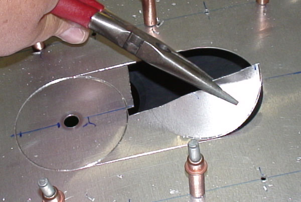

Something like this http://www.aircraftspruce.com/catalog/topages/holecutter.php
I prefer the type that doesn't use the drill bit - it simply has a center shaft the same size from end to end. You have to drill the pilot hole first and then use the fly cutter. With thick stuff and a drill press you can turn it under power otherwise the best approach is to turn it by hand and score the material. In the attached picture I made a inspection hole by:
1.) Scoring the metal by hand with the fly cutter. This is in the leading edge skin.
2.) Using an OLFA knife (see www.601.org) to score a line connecting the edges of the two circles.
3.) Used a step drill to enlarge one of the pilot holes large enough to insert a nibbler tool which I used to split one end enough that I could get my pliers on a scored edge and...
4.) Carefully worked my way around the hole, separating the the pieces I wanted to remove.
There.... that's more of an answer than you probably wanted Smile
Tim
Removing metal that was scored with a hole cutter.
