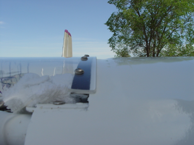

OK… Just to clarify.. It is not uncommon for the tanks to sit above the capstrips.. Sometimes one either builds the capstrips up or just leaves it alone… some have gone to the length of installing another capstrip on top and sanding it down to match the tank flange. If the tanks are placed in the wing and they do not rock from corner to corner then the twist is pretty close.. about an 1/8” rock is not uncommon. At the leading edge there is an allowance for the spar reinforcement bracket that sits up high as well.
<![if !supportEmptyParas]> <![endif]>
Just a few pics of one.
