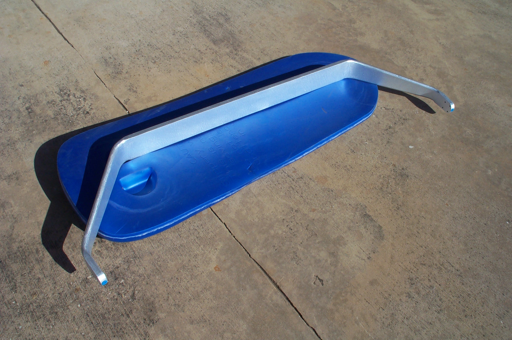

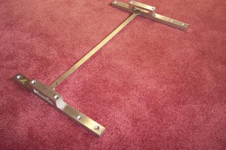

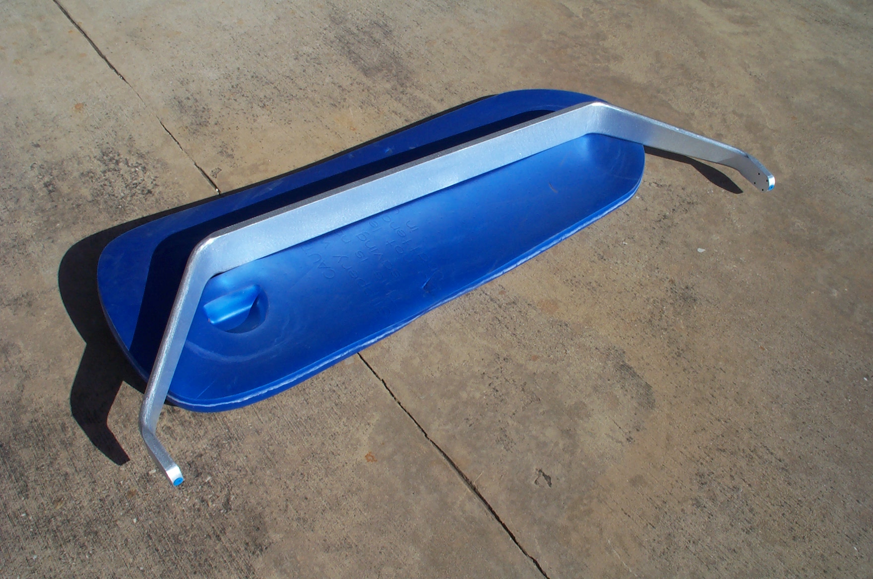

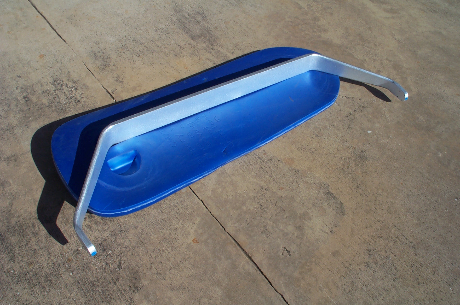

Michael,
I purchased the Grove Gear for my 601XL QB kit. Grove does not specifically list it on the website but if you call them they can give you a price. The main issue will be the mounting of the gear. I plan on using the original Zenith mounting brackets but I will have to hog out some aluminum saddles to take up the extra space. Aaron Gustafson sent me pictures of his installation on his HD. He drilled a hole in the center of the gear for the attachment of a lateral brace to keep the gear from sliding side to side. The HD mount will not fit the XL but the concept is the same.
I have included pictures of my gear and of Aaron's mounting hardware.
Bob Tezyk
N78QT 601XL QB / J3300
Started Elevators
The Grove 601XL Gear

Gustafson Mount
 Filesize:  34.92 KB
 Viewed:  523 Time(s)
