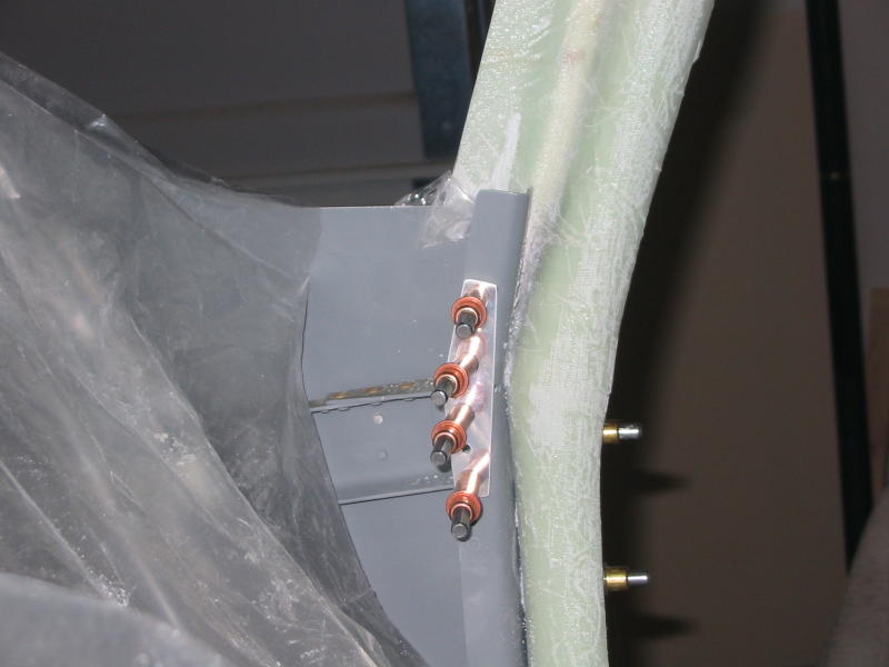

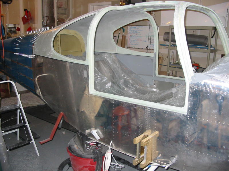

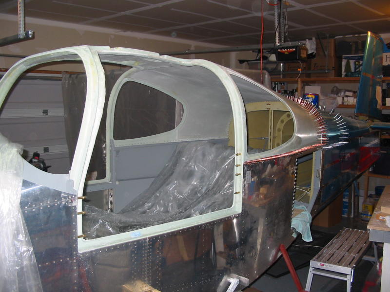

Rob,
I think that would be tough, though maybe not impossible. There might be some rivets that are hard to get to near the point that the canopy rests on the upper forward fuse. I was looking at these pictures of my canopy installation to see if there was anything that would prevent from doing things in that order; I'm not really sure, but maybe they'll help you.
-Jim
40134
